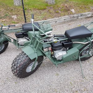

The noise exists in both bikes, when the rear wheel is off the ground the sound disappears. The front bike is geared slightly different due to larger tires (25"x12").
Top speed is around 22 km/h. We first ran the small bike without a jackshaft and the top speed was ca 40, the noise was there...
My honda clone is making a quite loud whining/squeling noise whenever I put any load on it, but disappears at certain points during throttle input.
The engine is used to power a homebuilt mini-bike with 22"x10" ATV wheels, the power is transferred through a 2:1 reduction wet clutch -> 11 ->...
