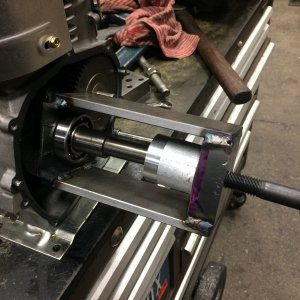

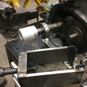

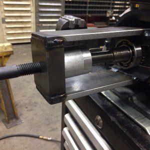

I have been using this puller for many years, but for a lot of jobs, it just did not have enough 'reach'. It's not rocket science by any means, but I made these four new plates, and now I can pull stuff off like pulleys that are closer to the engine block. I also had to grind one of the hook...
