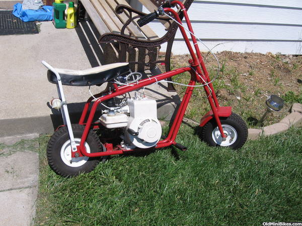

Heres my As found Lark Bird with the Nanner Seat. Its stock with the straight handle bars.
Also your is early like mine. Notice the single steering support on your neck. They really beefed this up on the later bikes. They tend to shear off at the neck after a while.

are these pics original on the duck's. i know some of my bird isnt stock, like the scrub brake brackets (they are crooked with nasty welds) , and the seat. how about the years, when where ducks and larks made and what are the differences?

I think mine is a Drover,after looking at the brochures. The Drover and the Duck look the same, but the Drover has 5" wheels and the Duck has 6". The Drover was Sold by Sears and maybe Penneys. The Larks, Drovers and Spyders in the brochures have 5" wheels. I'm going to take the top off the seat post and add a straight post, and banana seat, to make mine a Lark. I got the new rear wheel and tire on today and the new tire mounted on the front wheel. I found Carlisles, but they don't have the Indian head. I also put on new fenders. The original ones were shot. gbones, the neck bracing on yours looks like Roper bracing, like the Sears/Ropers. Roper may have made a few with leftover Bird frames????????? That's the second one I've seen like that lately.
