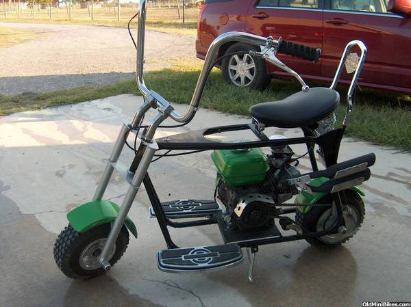

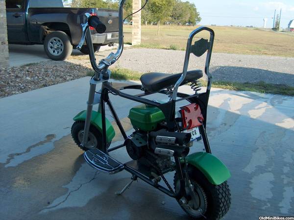

I hope this comes out allright.This is my first build it started out as a $100.00 mini.Don't know what kind.It was orange with a new honda 4 HP on it,no brakes,different size wheels,cheesy seat and twisted forks.I built new forks and modified the frame.I welded the fender bolts to the underside so they wouldn't show put a dash on it set the rear wheel back and added seat and sissybar mount.Friends with bike shops donated the handle bars,floor boards and sissybar.The rest was from different stores and E-BAY.I sure hope these pictures come out.Sorry I have no before pics
This was built for my grandson,right now he is 8 months old.

Very nice job COOP! I noticed you said your grandson was 8 months old?
I guess grandpa will have to ride it for a few years..

Very nice original design. I really like the floor boards. I notice it is headed toward that big field.

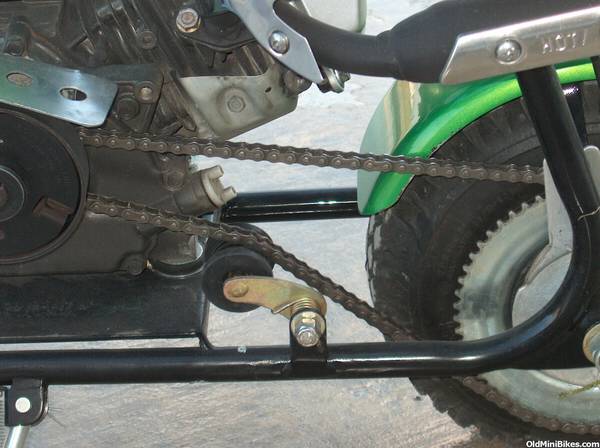

Very sanitary! What did you use for the trick little chain tensioner with integral spring??

Very clean bike!
I had seen a set of pipes like those before on eBay & thought that they would look pretty cool on a bike. I was right... They do look cool!

Thanks guys and yes that field has seen plenty of action.The tesioner is from Tractor supply,it's a replacement part they had in stock.If I remember correctly it was for a Baja Warrior mini cycle they sell.The tensioner and spring come seperate both were less than $10.00.If you don't have those stores your way maybe you can get online if not let me know I'll pick them up here and send to you if you want.The pipe is from E-BAY but I had to rebuil the complete front half to fit the honda motor.Prebent conduit from Home Depot and the flange from the stock muffler.Hope the conduit lasts.They are conected for that true twice pipe sound.Truthfully it sounds really cool.

Thanks for the info on the chain tensioner; Trick piece at a good price! Something we can all appreciate and use!
