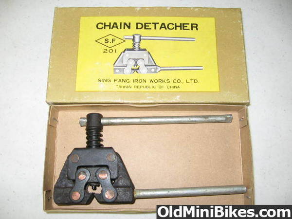

Ok I need to know of a good chain breaker to purchase. One that will get the job done. Well I purchased a chain breaker not knowing it was a piece of $h1T. It completely bent the link and didn't even get close to popping the pin out. It looked like this.
My chain is #41 size.

I use one just like that. Just push the pins as far as they will go then use pliers to pull it apart.

O mine isnt a sing fang. Ive had it for years. I believe its made in the USA, GO figure.

i have one of these and it's pretty kick ass. i like it because it holds the chain in place. it can also be used for re-installing the pin.

I purchased one of the Ruttman chain breakers like eBay item number: 120328332175
I read the glowing feedback buyers had left on this style.
The first time I used it the pushing pin bent....I never bothered to leave feedback.
I bought an Azusa Engineering chain breaker(Blue one) which kept allowing the link to twist, and bent each new pushing pin that Azusa gives as spares. Turned out the cradle you rest the link in to position it for the pushing pin of the tool was too large a diameter allowing the link to lean. I later found a chain breaker of the same design, but a smaller cradle which now holds it all straight and it works fine.
Most of my friends use the style in the first post here, and after they hit the end of the link with a grinder they get good results from the tool.....ha.

I have the one like in the first post but it is American made by one of the chain company's. I have used this type for 35 years. The one that BMI sells looks real nice and I still have to order one, the feature of being able to refit the side plate and not using a master link may be an advantage.

look no further than that one, only draw back is they come for one size but thats why it works GREAT!
