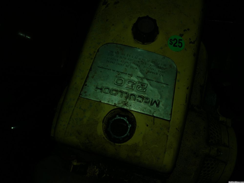

    Thanks for that. I bought it at a swap meet for $10 and in the shed it went. Haven't looked at it since. I believe it is the Super 250 and it looks older that the '70-'75 era. I'm surprised at the date on the link actually. Mine seems more rounded than the one in the pic. I was thinking mid to late 60's.
    So what do I need to do to convert this one to a kart motor? I think I've read that I have to make sure it's got a stepped PTO. Other than that what would it need besides a mount? I will take some pics tonight and I will start a new thread.

    Yeah it could be useful. Like yourself I've read about converting them but I've never seen a step by step with pictures. I shall do that!
    For now here it is. I crept into my shed in the middle of the night. Sorry about the darkness of them. It's not a super 250 after all
