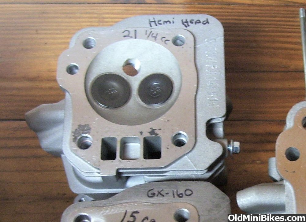

    Quote Originally Posted by DeadPixel View Post
    I'm curious dose the GX160 head have smaller intake and exhaust ports than a GX200 head? I have not had a 14cc head yet only the UT1 18cc.
    Yes they do , still usable but need a lot more work in my opinion ....still a great little head when ported and bigger valves installed.

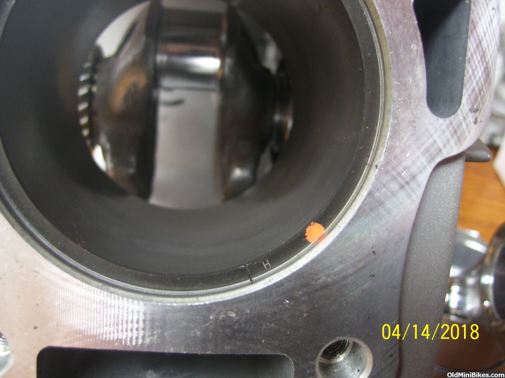

    Checking Ring Gap
    Weather your using new rings or just check out the gap on your old rings . Install one of the compression rings in the cylinder and use the piston to push it down equally and measure the gap .
    Installing the new rings. Everybody does it different , I like my ring gaps straight across from each other....but this is just what I do.

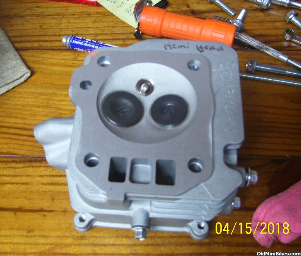

    After milling the head around .060 which took me from a 22cc head down to a 17cc head .
    BEFORE
    AFTER
    Was able to get some good measurements for the push rods... with a .010 used head gasket , so I ordered 5.440 long push rods from NR Racing . Also ordered a new Predator .010 head gasket from Russell to.
