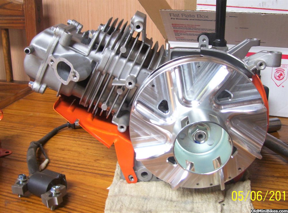

    Flywheel came in today , and yes it's a Raceseng GX200 flywheel from the boys at EC Distributing. Got a good deal on this one $89.00 and free shipping.

    Flywheel Installed with a 4 degree key , 34 degrees total advance.
