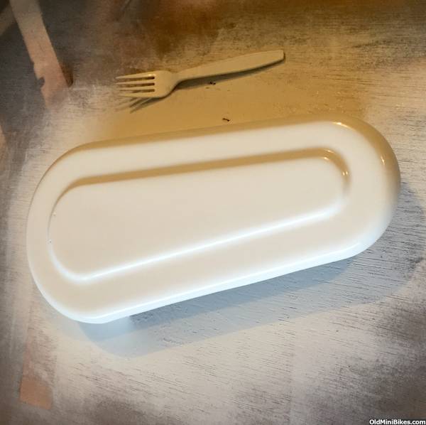

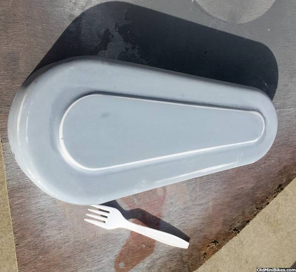

Paint arrived today. Filler primer for the base, premixed color to match the motor, and Spray Max 2k for the clear coat. I applied three coats of primer and wet sanded with 200. I got two coats of the white base coat applied. In a couple of days I will apply the decal and clear coat...:thumbsup:

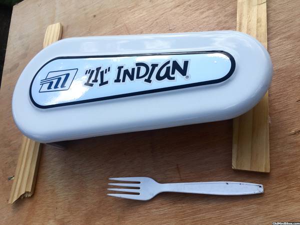

The decal arrived today. After applying the decal, I applied two coats of the Spray Max clear. It really finished it nice:thumbsup:
