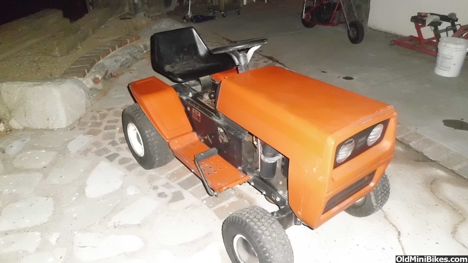

Heres my Tractor Progect im working on. Building it from scratch since im too cheap to go out and buy a wheel horse or somthing like that. Iv got a 5hp tec going to a right angle gear box to a peerless 5 speed and then a peerless diff. I still dont know what im going to use to make the rear fenders or how ill design the hood but one step at a time. Crappy pics but I gotta show you something :laugh:. Heres the fun part. I have a little vintage snowblower that im going to use on the front of it powered right off the engine pto with a dual pulley. And Im going to make the down shaft of the right angle gear box power the mower deck which is the old deck of a snapper push mower. It will be quick release but the height wont be adjustable and itll be powered whenever the tractor is in motion. And Iv got a little plow from the back of a roto tiller that im going to make boltable to the back end of it for digging ditches or whatever. Im not sure how well all the attatchments will work but I figure If i get atleast one of them working good It will be a usefull machine :smile: Im still not sure if i want to leave it ratty or paint it up nice we'll see how it looks after its all mocked up i guess.

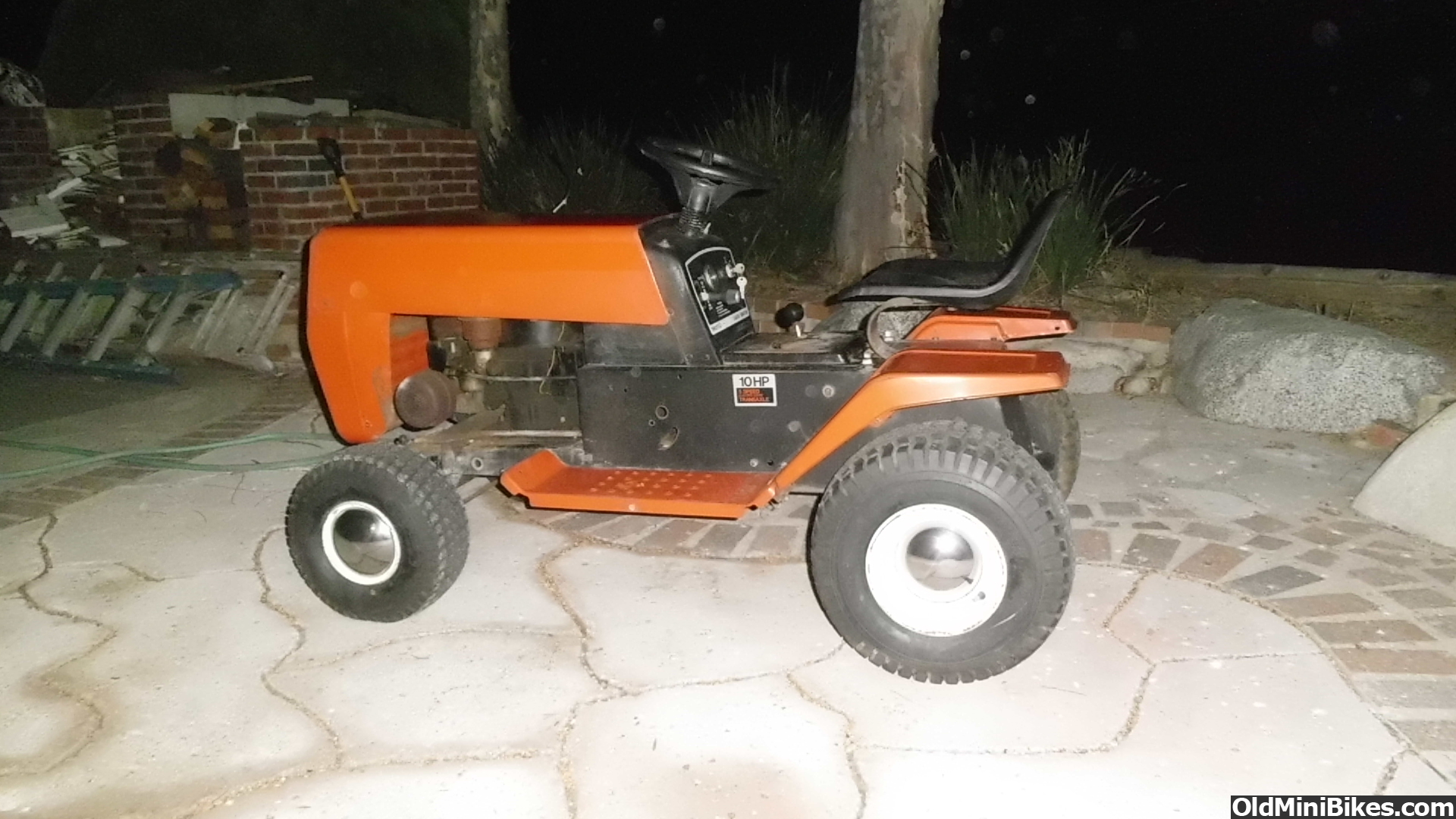

Heres the old snowblower. its chain drive so ill have to build a little jackshaft onto the engine plate. Thats an old pic i already used that engine on somthing else
im going for somthing like this maby not quite as pretty though
