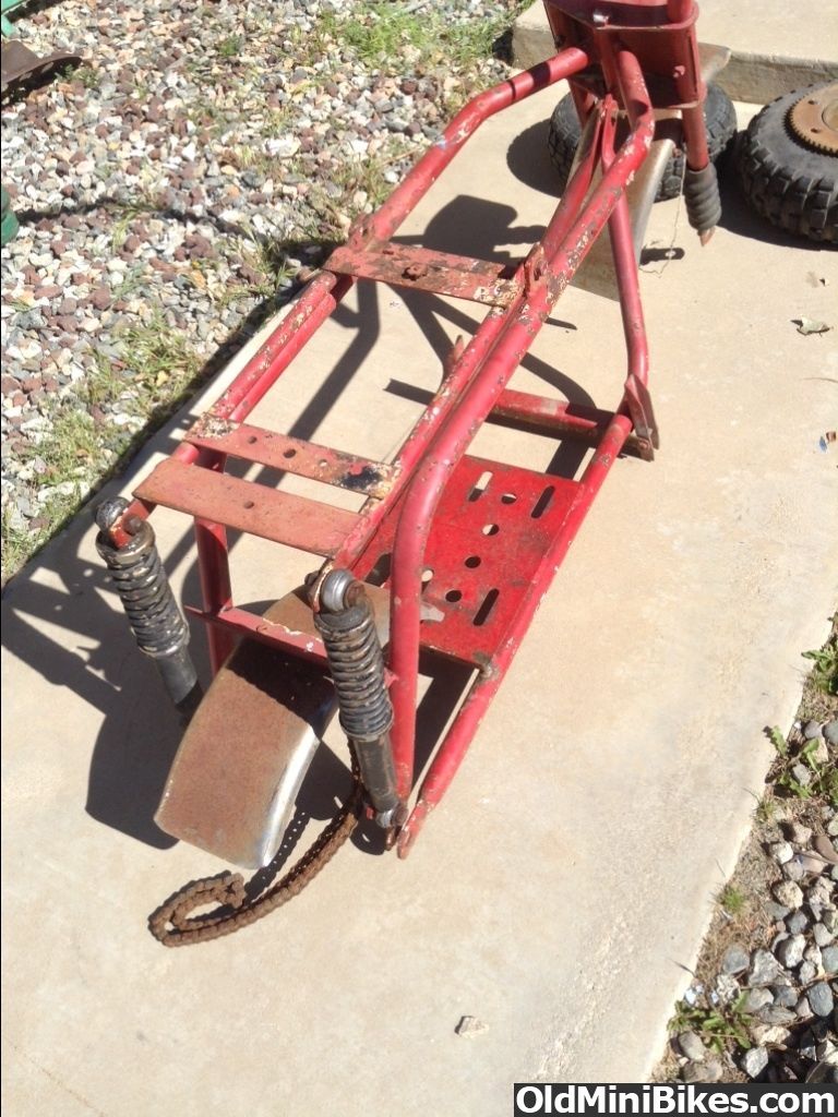

Some may have seen this one ebay 2 weeks ago, I'm a sucker for bikes like this so I set my auction sniper and ended up winning, thankfully for much less than I anticipated. First thing I did was contact cheezy and he made me a deal on the Barris chainguard He had bought that turned out would only fit the suspension seat model.....he has a swingarm one. I just got the bike finally yesterday, Its not any nicer than it is in ebay photos. Did come with the rear axle assy that was not listed but thats it for extras.
ebay listing pics

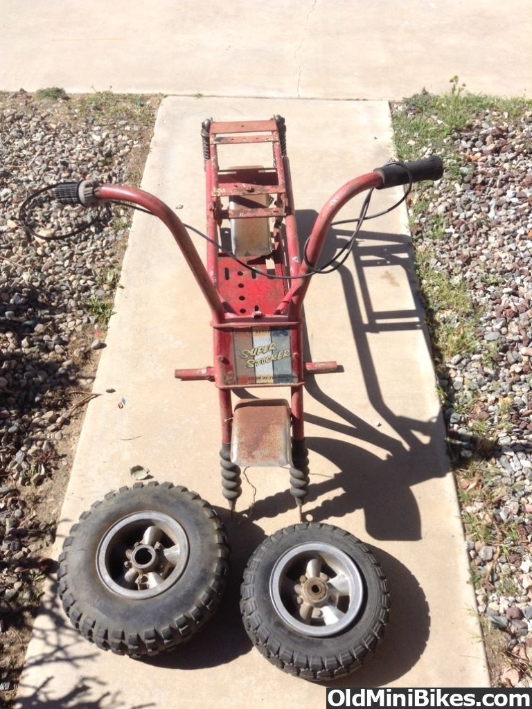

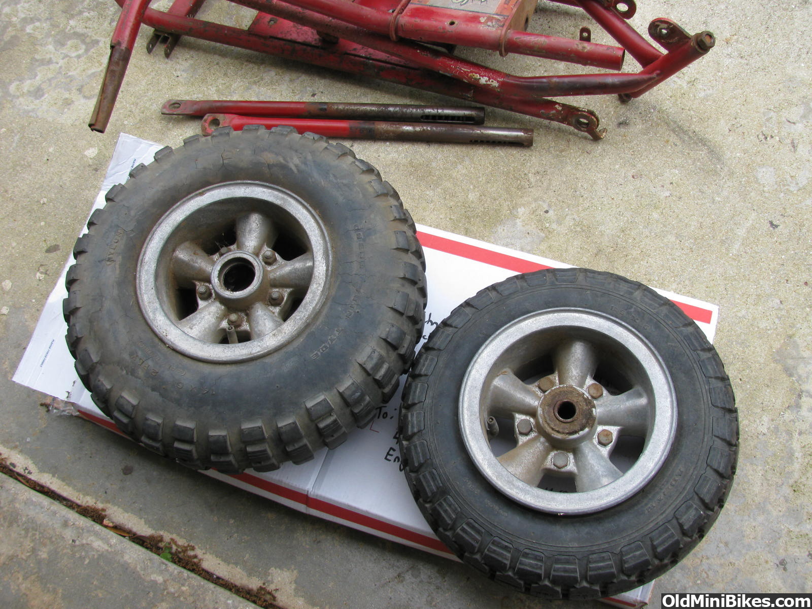

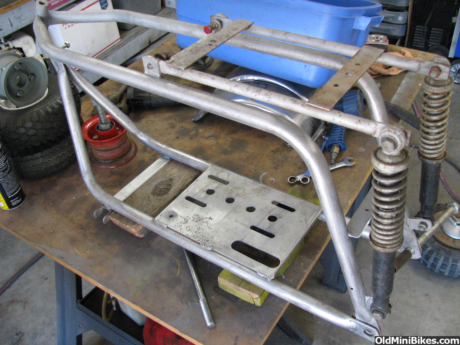

first thing I did when I unwrapped it was take it totally apart, the fenders and shocks (I disassembled them too) got tossed in the some degreaser solution and are soaking the rust and paint off. Tommorow I will pull it all out and see "what lies beneath"

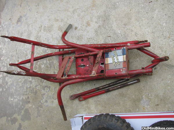

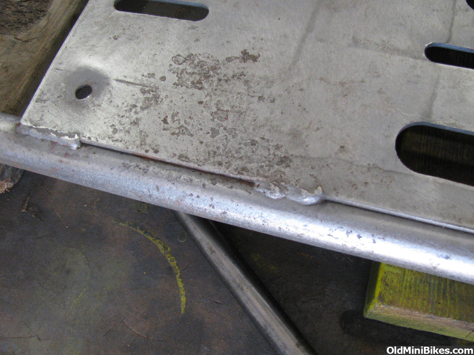

Bike is very straight and pretty clean to work with, painted red over the original white frame and silver/black bottom forks, but not really modded or damaged.....well except for what appears to be an added plate under the seat and this :doah:

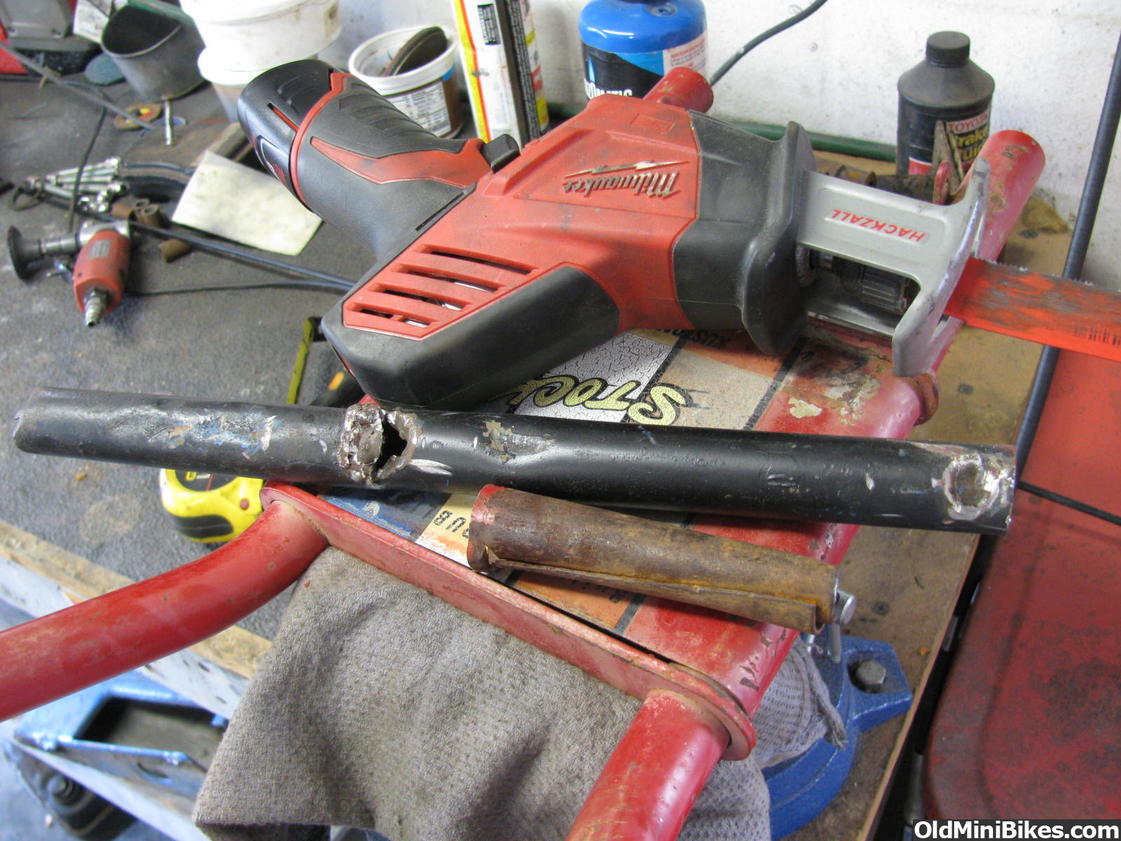

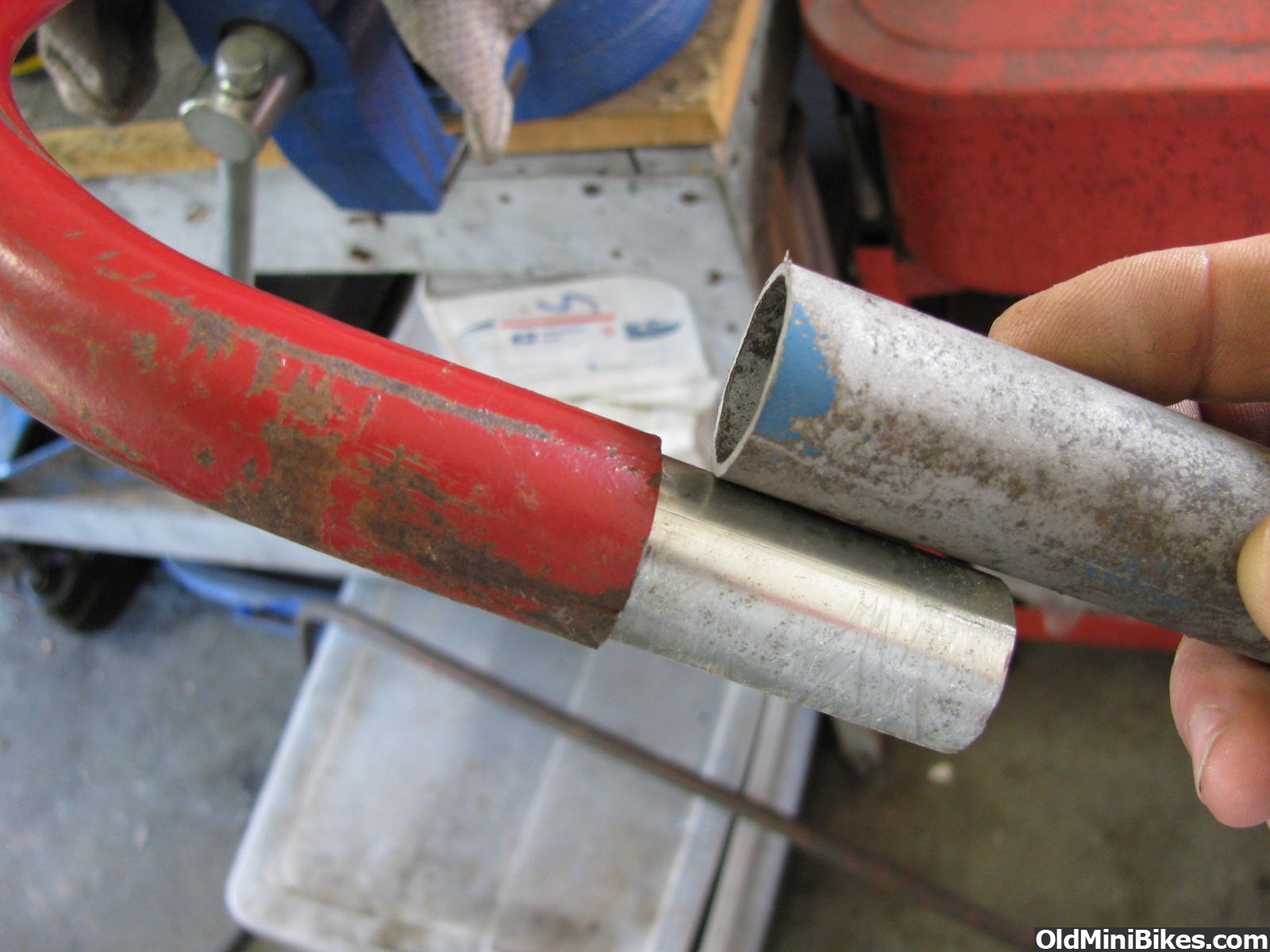

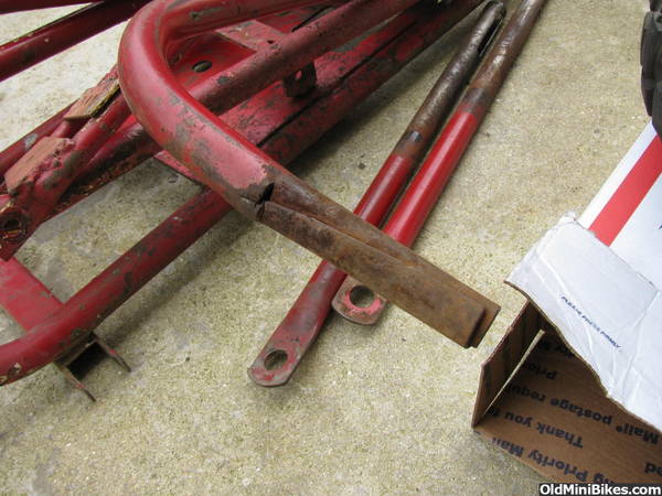

something I have seen in one in every three 1" handlebar bikes I have picked up over the years, the old 7/8 throttle to 1" bar conversion!!! This ones pretty crazy, they cut and twisted the tubing to shrink it down....Ironically the throttle did not work so it was a FAIL on their part. I dug through the scrap pile and found a piece of 1" and thankfully a piece of tubing that fits for an insert/sleeve so that should be pretty easy to fix out of scraps.

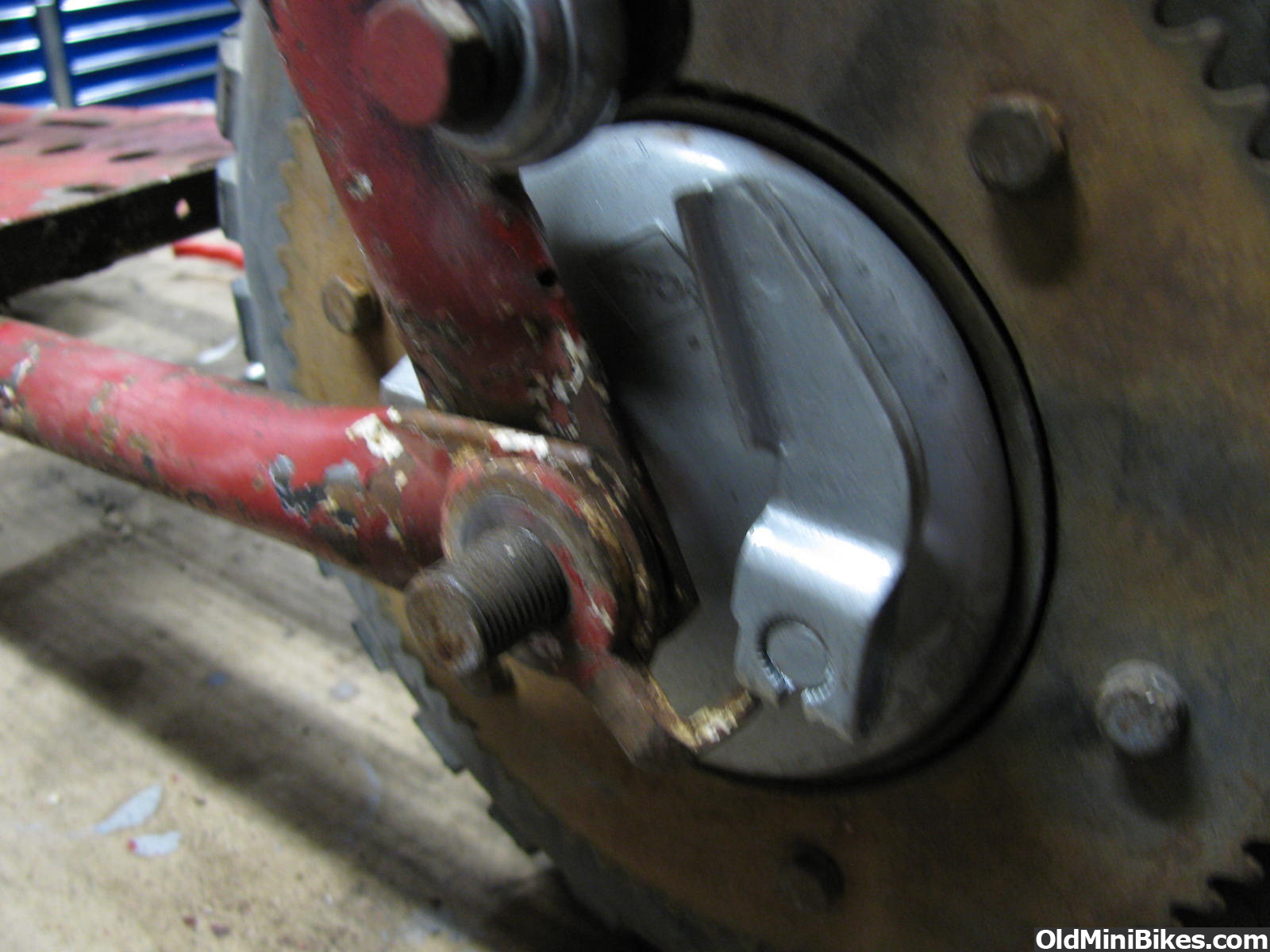

Gonna need to figure out some seat measurements and what kind of engine I want to use. I have an NOS victor brake assy that some of the bikes with tablocs used, it fits the tabloc drum but I will have to mod it a little for it to fit this frame, so if anyone has the 4.25" flat plate brake available that would be cool too.
