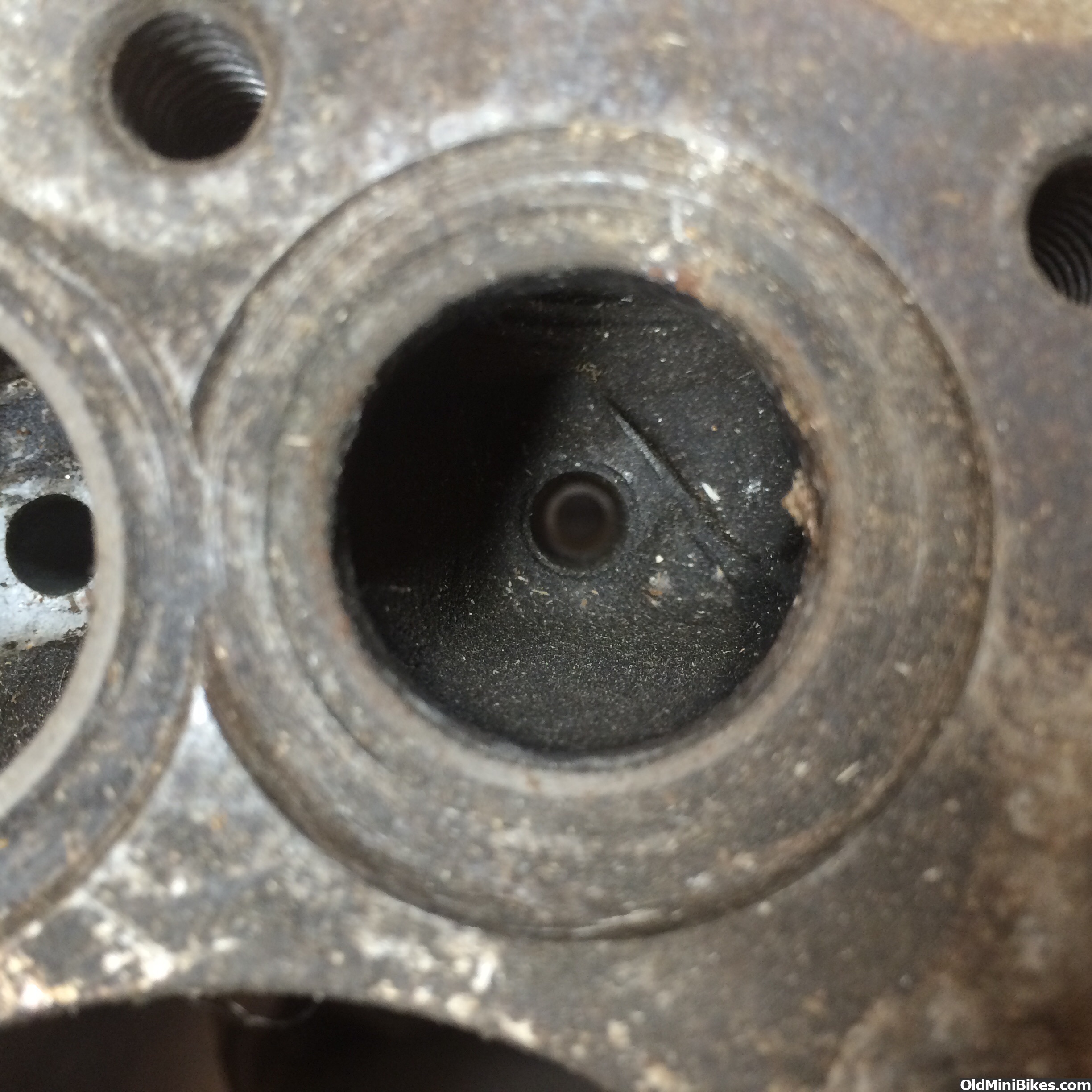

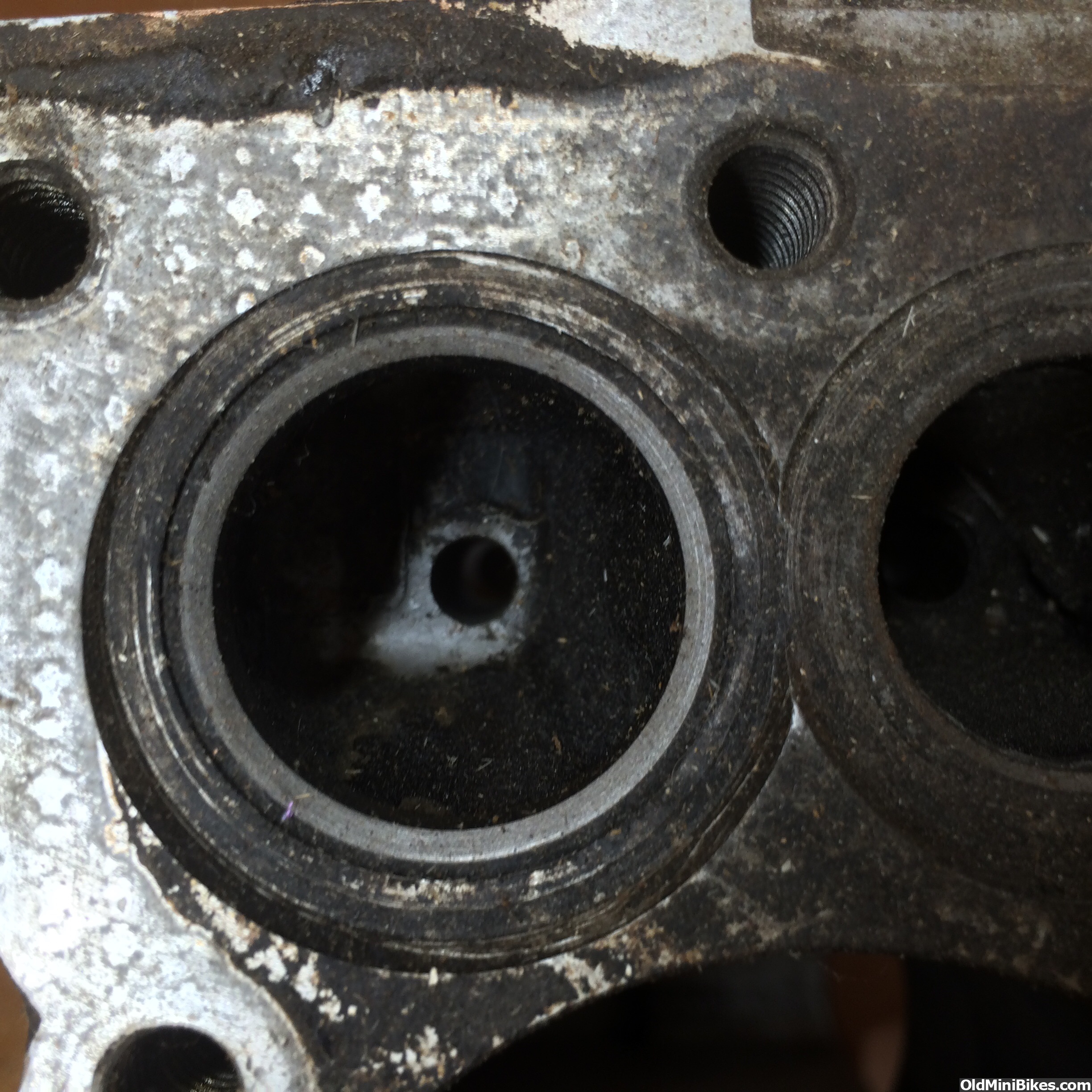

which block do you have? is there a guide in the exhaust side now or is it riding on the aluminium block? try and post a photo
