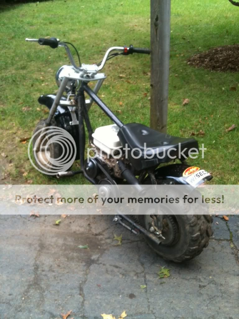

On my last baja I shortened the rear and front fenders, in the process of doing the same on this warrior. I was planning to run without a front fender until the last ride on mostly mud trails.
I think the shortened fenders improves the look of the bike substantially
#31
i would get a cover but theres no way to mount it. i have a very weird engine plate for the jackshaft and nothing will fit.
i dont know if it looks better or not now. maybe i cut a little too short. hmm. too late so whatever. just looks stubby in the back :shrug::laugh:
