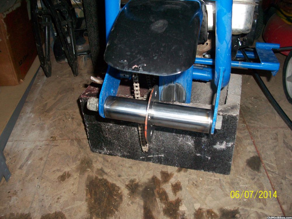

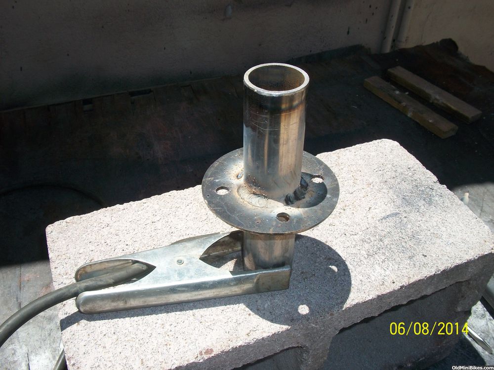

Well the tubing I have is not DOM, and is probably HREW (maybe CREW). I did make my own wheel hub, with sprocket flange, despite the discouraging words I've read in years past about this subject, ( You'll never get it right!!! It's not possible with only hand tools I.E. hole saw, calipers, TAPE MEASURE!!!) Don't ask me to do it twice but Bingo Bango! Walla!!!... See pics Below:thumbsup:

How did you true it up? Any issues with out of round? I have a dial indicator and access to a plasma cutter. Was thinking if I used 1/4 plate and a plasma I could cut the flanges without too much distortion. Then a couple spot welds and the dial indicator, some creative hammer work, maybe round enough. But, the jackshaft and go cart flanges is starting to look better. One issue with that is the pillow block bearings do not lend themselves to being able to adjust the chain easily. So an idler sprocket with adjustment or a dirt bike chain tensioner. Maybe that is not any harder than making adjusters for a moveable axle? Got part of the frame welded up yesterday. I will grind and prime it today. Ran out of steel, need to go to the big city next week for more. While laying out my original idea in wood I kept finding problems with it. So changed plans. Plans are good, we should have plans, we should follow plans, but not be a dam fool about it. Changing plans can be a good thing. A bit more thinking involved then I first thought, lol. First version had all the answers, great ground clearance, and a seat height only a pro basket ball player could deal with. Second version still has 7-8 inches of clearance, low seat height, tho it does take K-Y jelly to get the motor in and out. If I get time today I'll post a few pics so you guys can have a laff at my expense! And thanks again for the comments. BTW, That turned out to be a nice clean hub, what I was thinking of making.
