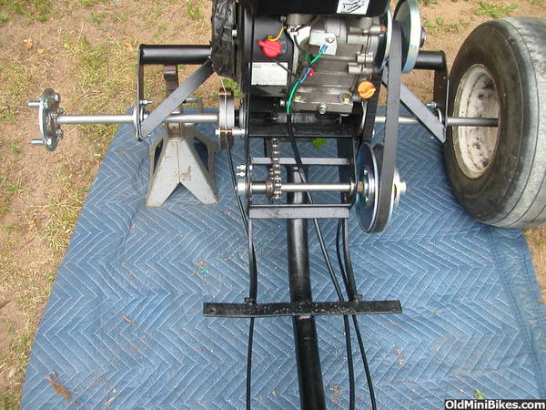

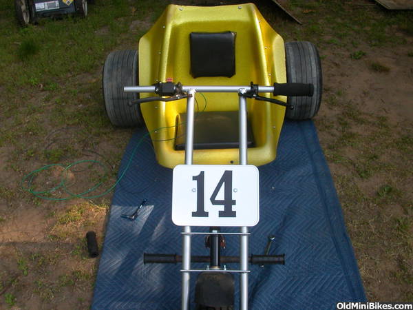

Looking good. I find you need to keep going back and forth tightening the bearings as you keep spinning the axles so they don't bind.. And the more you cut off the ends of the bars the easier it is to turn. Too long and you are "reaching" for the furthest bar. Just long enough to have the brake and throttle so they dont interfere with each other.
