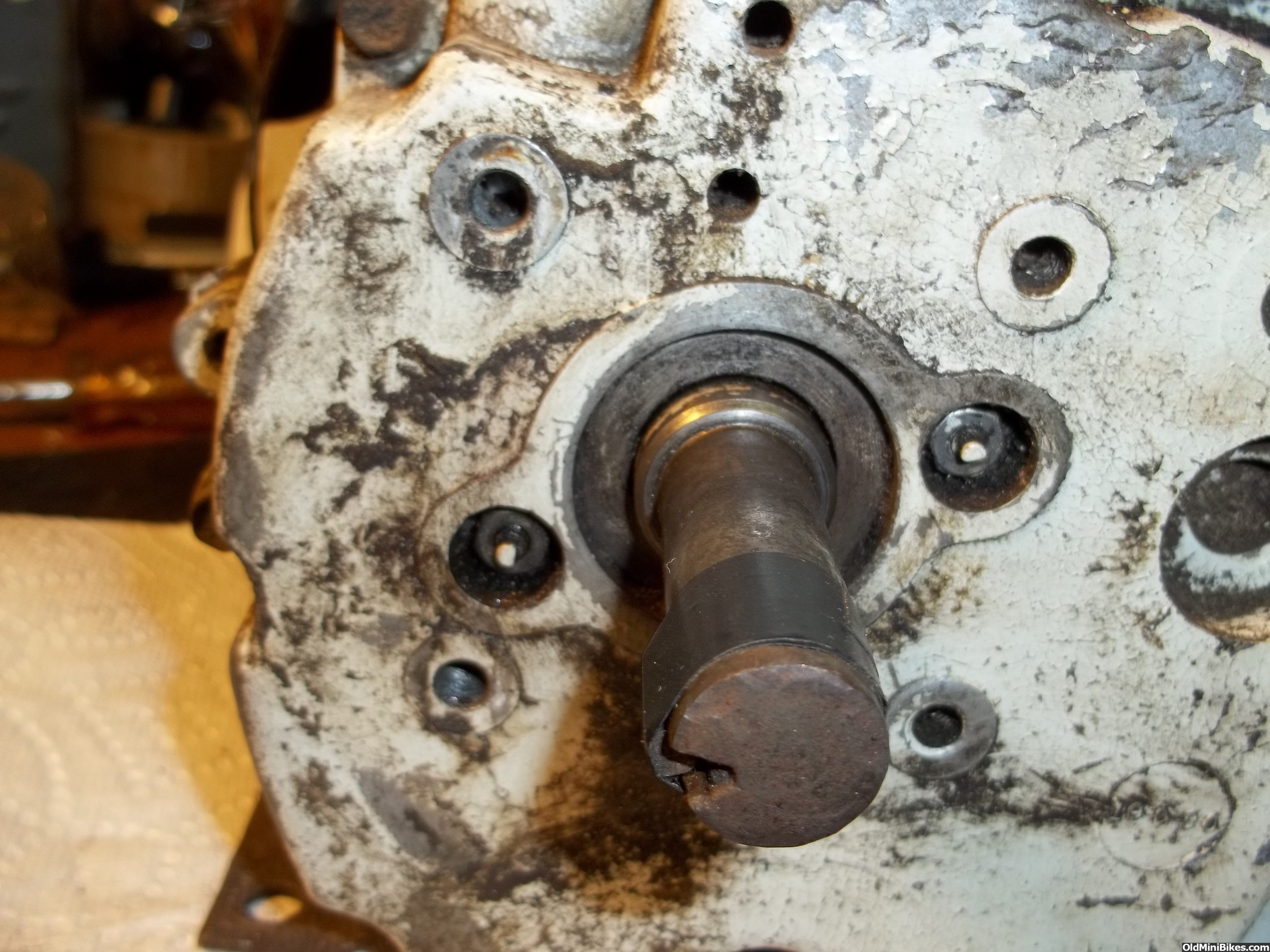

What are these 2 little nuts for? One each side of the output shaft with a little white bolt sticking out the middle of each one. None of my other tecumcies has these.

those are the roller bearing retainer clips,there is a slot on the top of the threaded end,turn one clockwise and the other counter clockwise if I remember right. after you do this the side cover will come off.
I thought they were some kind of adjustment. I will not touch them.
