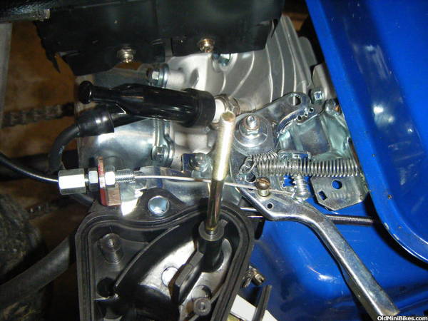

You can shorten the stock rod down to 1-7/8 inches long from the 90 down into the carburetor and were it fits into the stock throttle arm. Make sure to loosen the 10mm nut on the throttle arm so it returns easily but not too loose to come apart. and use a heavy return spring.
Here's a picture before I did the governor bypass. I will have to get a picture of the new shorter rod.
