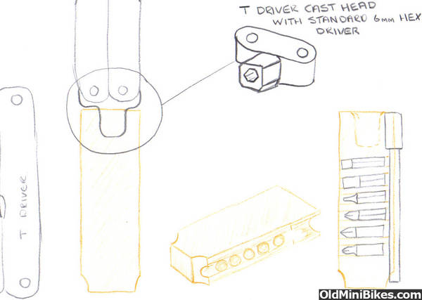

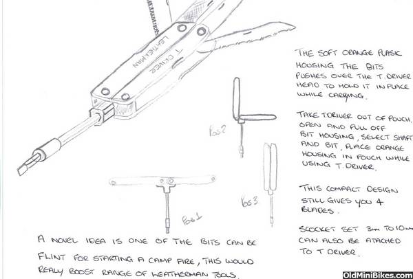

Sent this in 2005 to Leatherman - they said my Idea had no potential

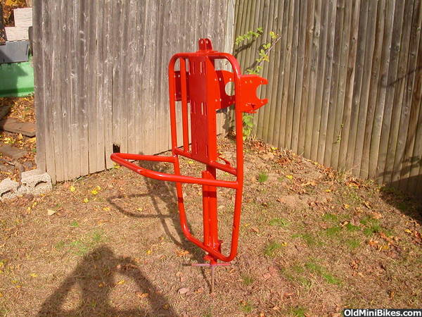

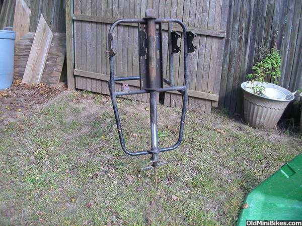

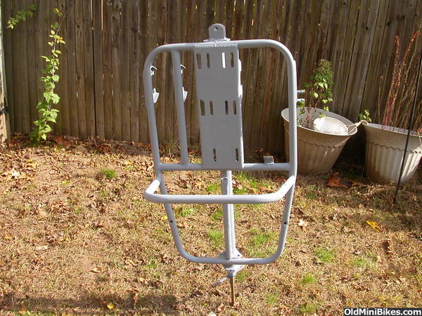

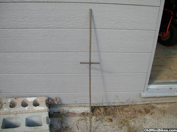

When I started redoing my Wards T555 I needed a way to paint the back half of the frame as it was too heavy to hang from safety wire as I do with smaller parts :doah:
Well the center bar of the frame was open all the way thru :thumbsup: so I had some 4 foot rebar, I cut about 4 inch's off one end :grind: and welded it to the longer piece :weld:
Then I took my trusty 3 pound hammer and drove it into the ground :hammer: Now I had a way to paint my frame being able to get all the way around it :thumbsup:

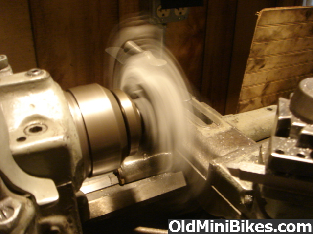

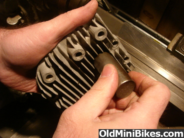

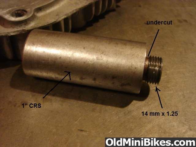

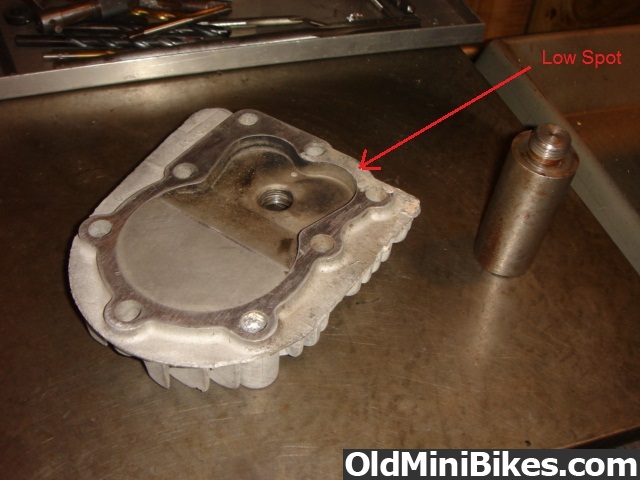

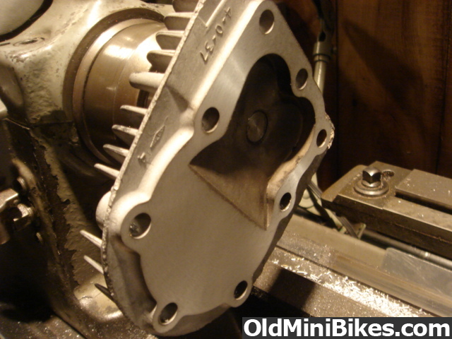

I was a fresh faced kid out of High School (1977) when I made this tool...still have it!
Screws into the spark plug hole and allows you to face off the deck surface in a lathe without all the setup time you have in a milling machine. I originally made it for moped heads...but it will work on most any small engine head where the plug is straight (perpindicular) to the deck.
Hey thats cool!
