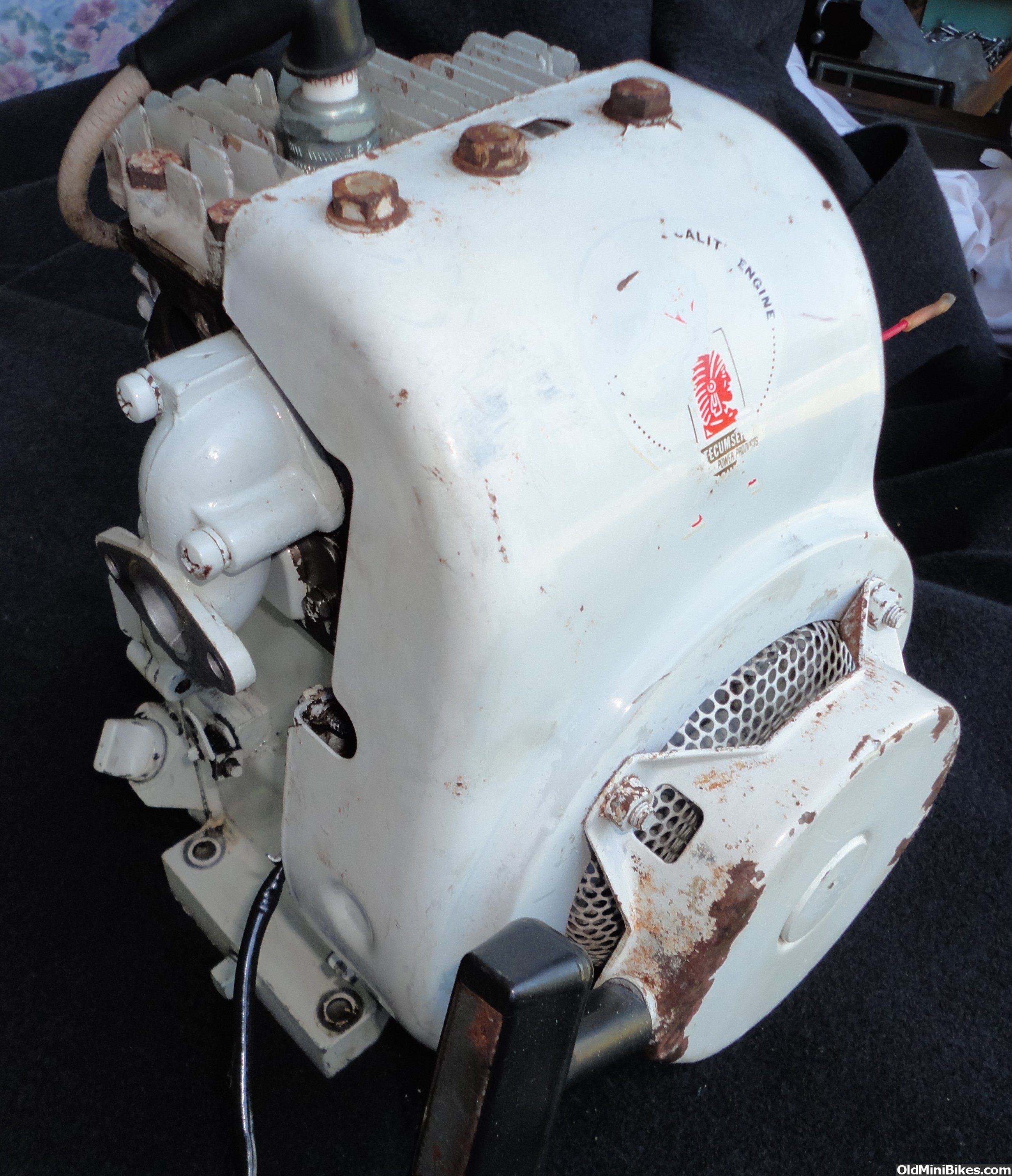

The top of the shroud is smooth (no bump up, like Tecumseh started doing in 1969). Lil Indian didn't start using Tecumseh engines until after they went to that design. Also, Lil Indian never used a Tecumseh that exhausted on the same side as the output shaft (if yours is like that, then it definitely isn't correct).
This engine is too early as well
This is the correct style engine (notice the ridge along the top of the blower housing)
