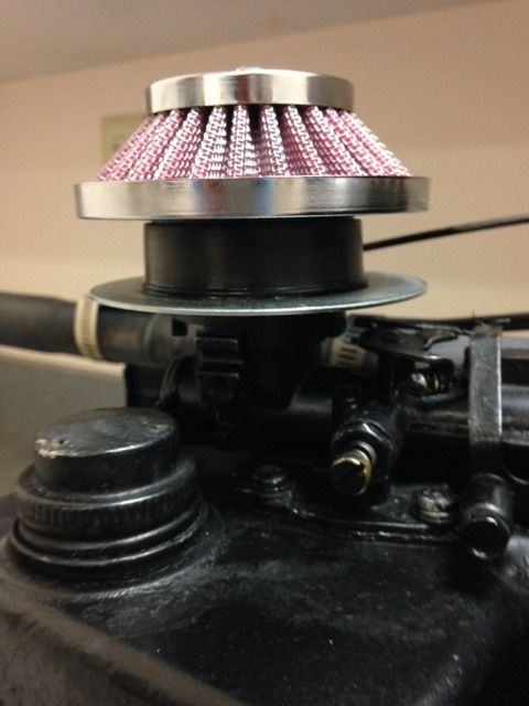

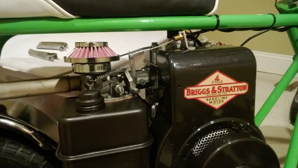

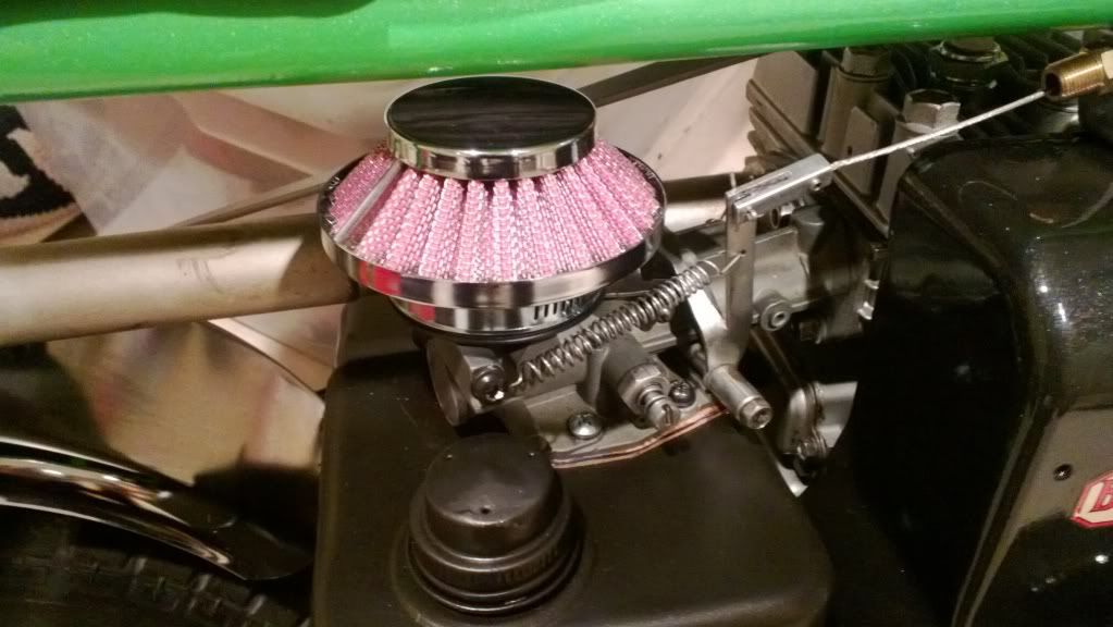

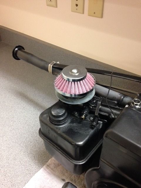

Bump of an old, but helpful thread. I found this thread when I was researching a filter to use on my 5HP Briggs.

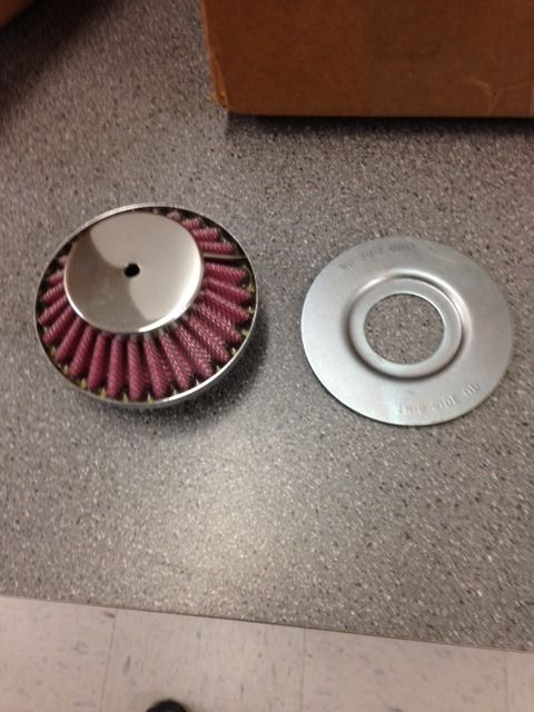

Ordered the filter & a base from a stock Briggs canister air filter (from Jack's Small Engines). Needed the base to lift the filter high enough to clear the throttle assembly.
There really isn't enough area to clamp the filter very well onto the carb, so I drilled the filter & used a 1/2" longer vertical mounting bolt. Worked out great! Here are a couple pics:
Thanks to vwfan79 for originally posting up the info on this filter!
