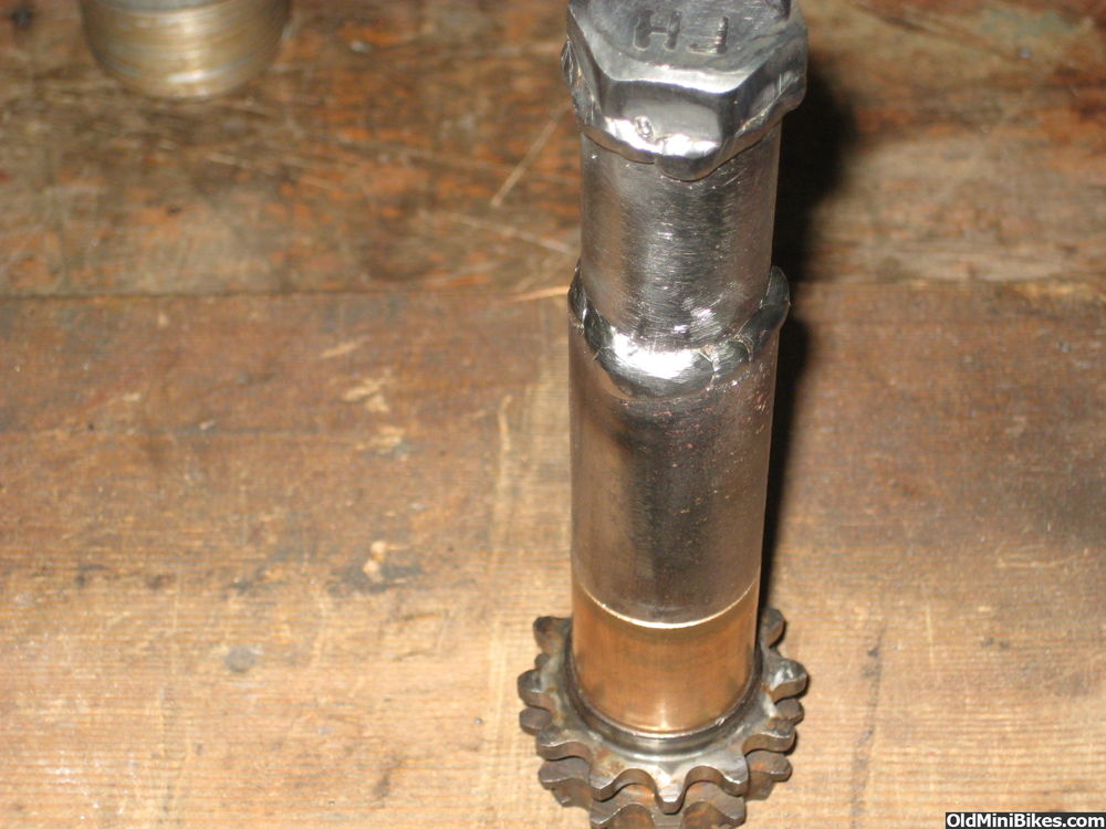

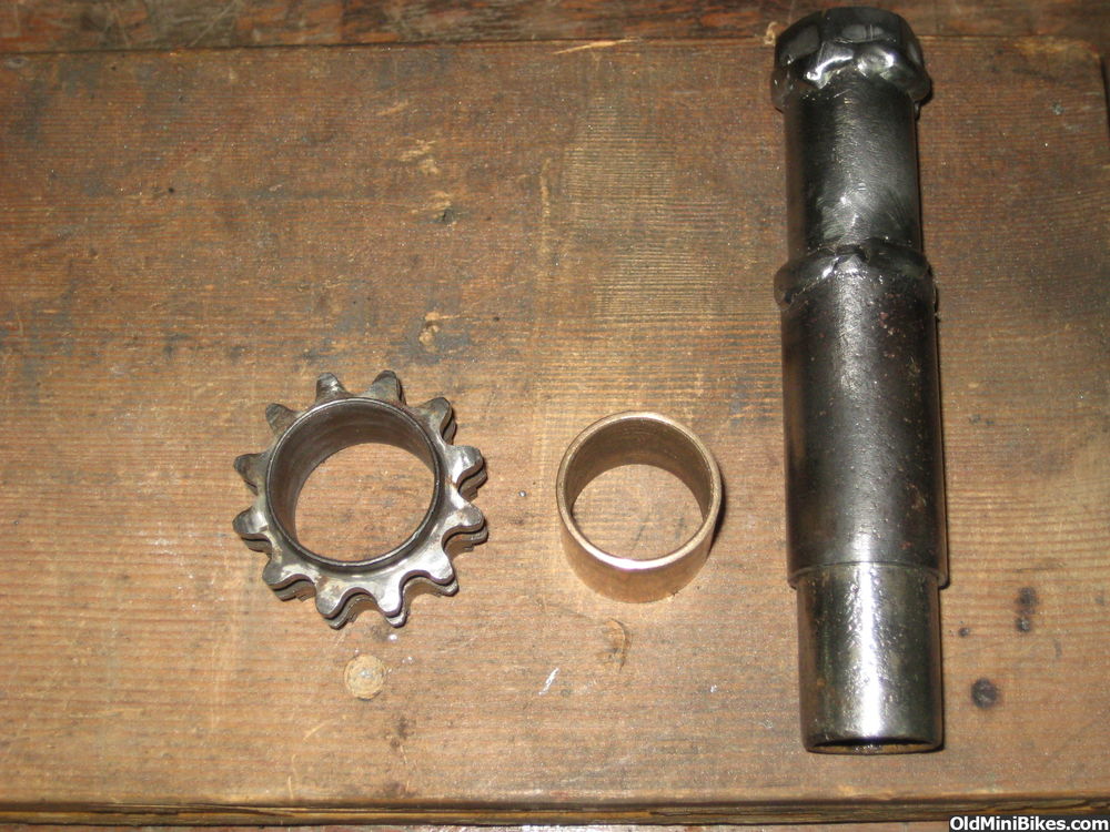

Max Torque Clutch Bushing Driver
You could probably use a commercially available driver as they come in sets. I didn't have one. I suppose one could carefully tap one in with a wooden block, or maybe a leather mallet. I have no press. They're in their pretty tight. My idea was to preserve the bushing so that it wasn't worn out just by me getting it in there.
