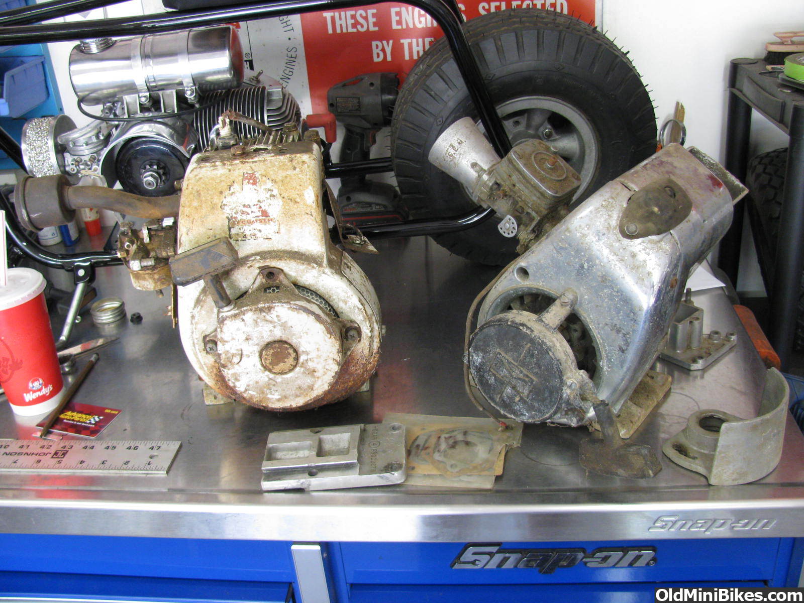

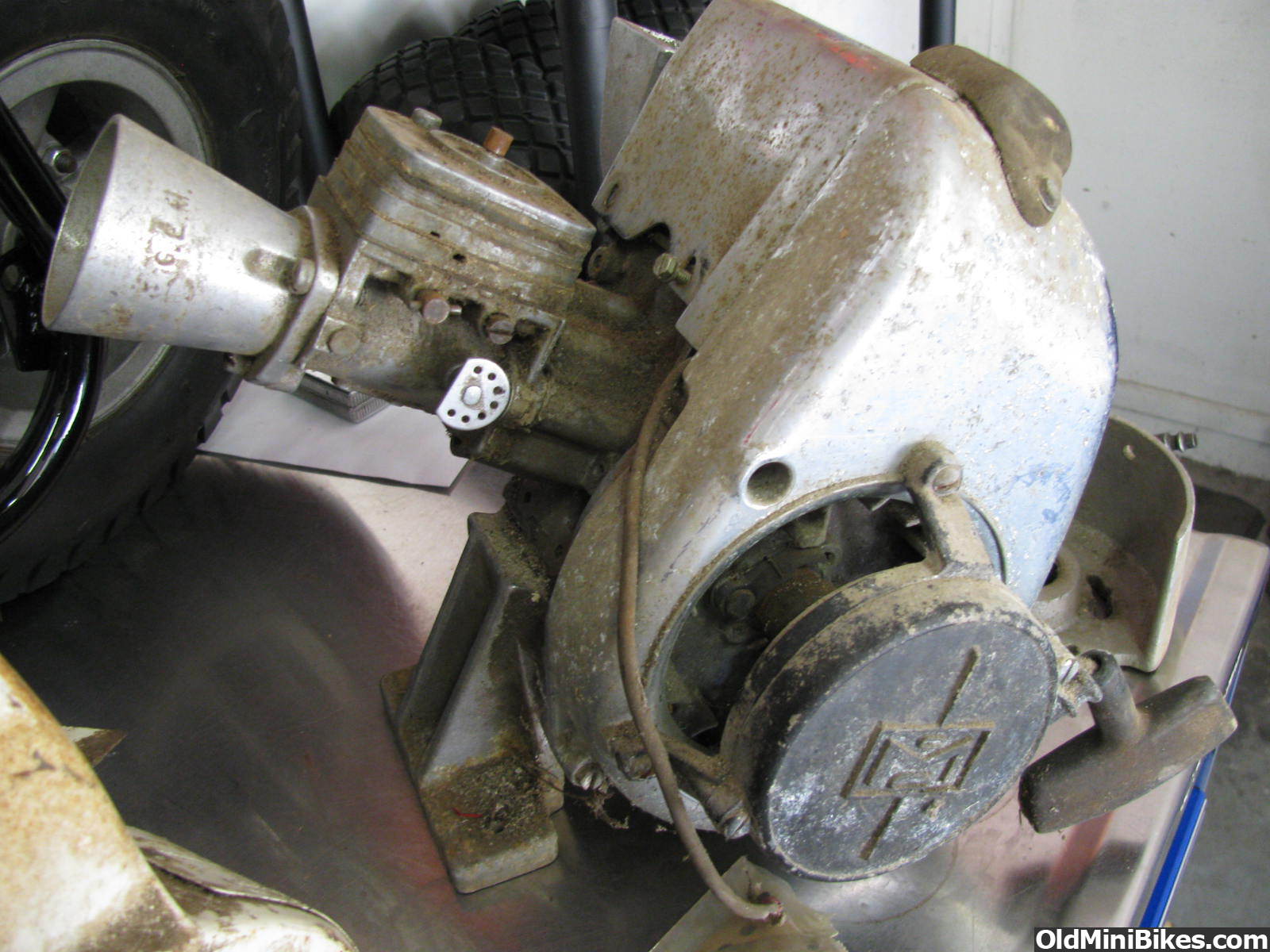

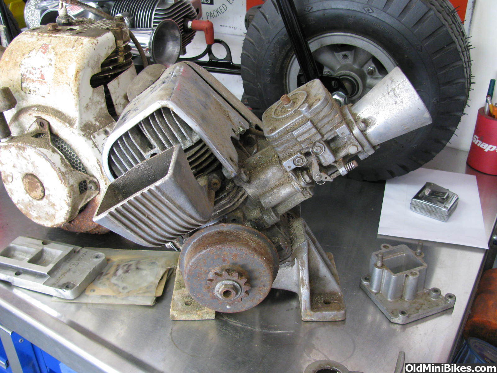

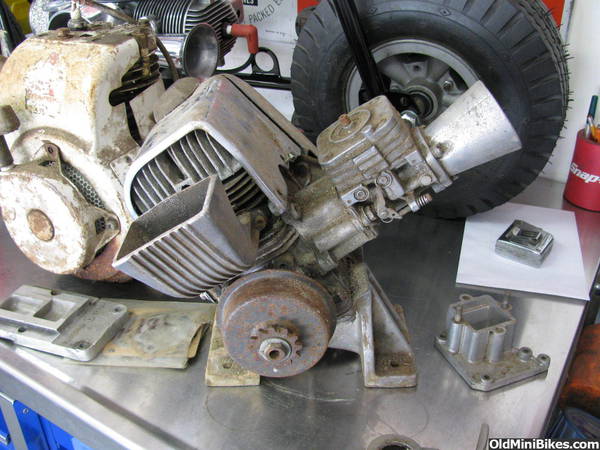

I went to pick up a 1970 HS40 tecumseh parts engine I spotted on craigslist today and when I got there and was talking to the guy He told me he found his old Mac off his kart too and offered it to me. He thought it was a "101"? Said it had been many years though since he used it. Its rough but its not frozen and appears servicable, the intake is actually not installed/loose so I was able to look inside and see it move etc. He said it was sucking air and he had torn it down to repair years ago There is a another reed block/intake that was in a box with some other parts that has a crack in it so I dunno if that was the problem or not.
Anyway any help to ID the size or whatever I need to know as I would like to tear it down and see if its workable but I know nothing about these engines and what is different between sizes and model numbers.

the shroud certainly looks like a 101...but let's wait for YOOP to pop in...that guy knows his MAC's!
I hope you bought this! The 101's are going for big money these days! The biggest issue is the flatback carbs...they have this "duckbill" valve that gets eaten fairly quickly with todays fuel. I removed the flatback from my 91 and bought a Tilly for it. I needed it tamed down a bit too!

So I just popped it apart a bit and ran it through the parts washer. I did a search and found some specs on the macbobaust site to compare. That was a lot easier to find info on it than any west bend, or power products I have!
It has a .010 piston, and bore measures just under 2.29 so its a 101. It has the machined recess for the rod in the case and it Also has the fingerports, cross all that up and it shows as a 101a
