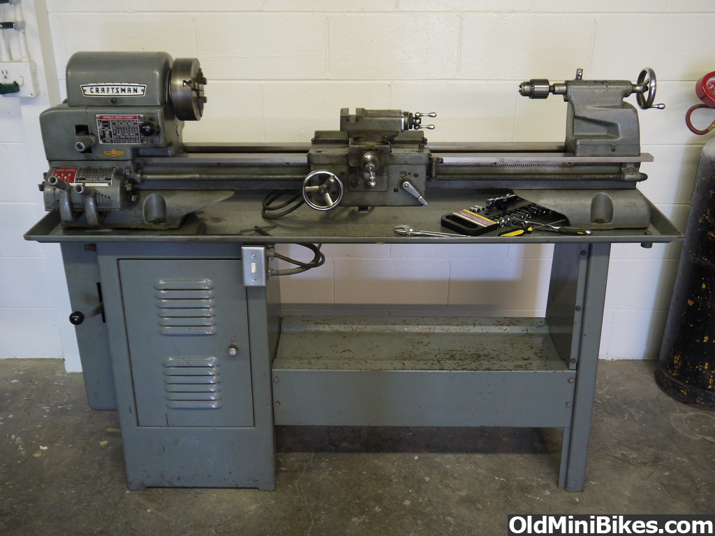

Very true. I probably have spent more money on tooling than I paid for my Lathe. I got lucky when I bought my lathe. I had been looking for 3 or 4 years and finally found this Craftsman/Atlas on Craigslist. I had to ride almost 3 hours to get it but it was the exact thing I was looking for. After talking to the old man on the phone he was a retired gunsmith that was dabbling in buying and selling machinery. He said that he bought this lathe from the widow of the man that bought it new. It was in a heated and humidified basement all of its life. It looked and performed like it was brand new. I gave $1250.00 for it 9 or 10 years ago. I searched Ebay religiously for the attachments and just waited on the right pieces to come along. I also searched and bought selective "Box Lots" of miscellaneous machinist tooling. Just have to look close at what you get. Lots of good stuff in these box lots if you hunt.
The number one improvement I made to my lathe that really helped overcome my lack of experience was to replace the Lantern style tool post with a Phase II quick change tool post.
https://www.traverscatalogs.com/lg_display.cfm/page/713/catalog/Master_2017
Once I did this and got all the attachments adjusted my results improved 10 fold. With a Lantern style tool post you have to set the cutting height every time you change tools or tool angle or need to sharpen the tool. With the quick change tool post you can change the cutting insert or type of tool or angle and back again with just the flip of the lever and slide the tooling on and off. I have square right cut and square left cut setups that allow you to cut shoulders quickly and easily. I also have some Shars cutting tools that fit the Phase II stuff very nicely.
This is a web pic because I didn't want to walk out to the shop and take a pic of mine. This is the exact lathe that I have. This is the last version of the 12'' lathe and I searched for this model because it was all self contained. The motor is 220 volt and it is inside the cabinet behind the louvered door. There are two pulley groves right off the motor for speed. Just to the left of the louvered door is a lever that allows you to choose 4 more pulley speed choices. The earlier models had the motor mounted behind the lathe and it took up a lot of space depth wise.
