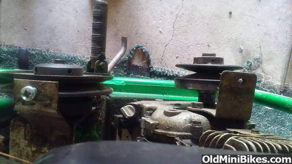

does this all look original, if so, why don't the pullies line up? new to these, sorry if this is a stupid question 14068145_1717828498470094_6805011504145085271_n.jpg 13939353_1717828501803427_42236152493988409_n.jpg

I've never had a bike with a belt, so I'm not sure if it is suppose to be that way to keep tension on the belt?
If they are supposed to be lined up, I'd say the front pulley is on backwards? or the bigger pulley is pushed in too far?
It looks like there is also a spacer on the first pulley between the pulley and the engine. Sorry, I don't think my comments helped, I'm just rambling. :eek:ut:

I'm with 45t...I don't think the bushing is suppose to be behind the pulley/clutch on the engine. It needs to be taken out of there...especially if its a true torque converter.

That is how a torque converter is suppose to work by sliding in and out....but it has to have some kind of centrifical spring system to make it close up....and I'm not seeing that on yours.
#19
exactly...theres a clutch on the rear pulley. I know how its supposed to work, just never messed with one.didnt think this looked correct. think ill get one of those aftermarket TC setups...
#20
Yep...I just bought one off ebay, you can buy the whole setup for like $75.00 and free shipping....I believe that would be your best bet. You will need to know the size of the engine shaft for the torque converter and the size of your jack shaft shaft for the driven or rear pulley.... or you can use there total set up that they sell...might be your best bet.
