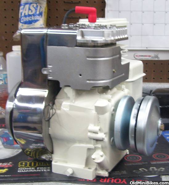

Here's what im getting, 30 series. the shaft is 8" now, do think it will need to be longer? the driven is the size of a TC already...
#38
JC, it needs to be long enough so that the driver and driven line up. It's impossible for us to tell until you mount them. At that point you can determine if and how much longer it needs to be. From the pictures I think it may need to be a little longer but I really have no way of knowing without seeing these items on the bike.
