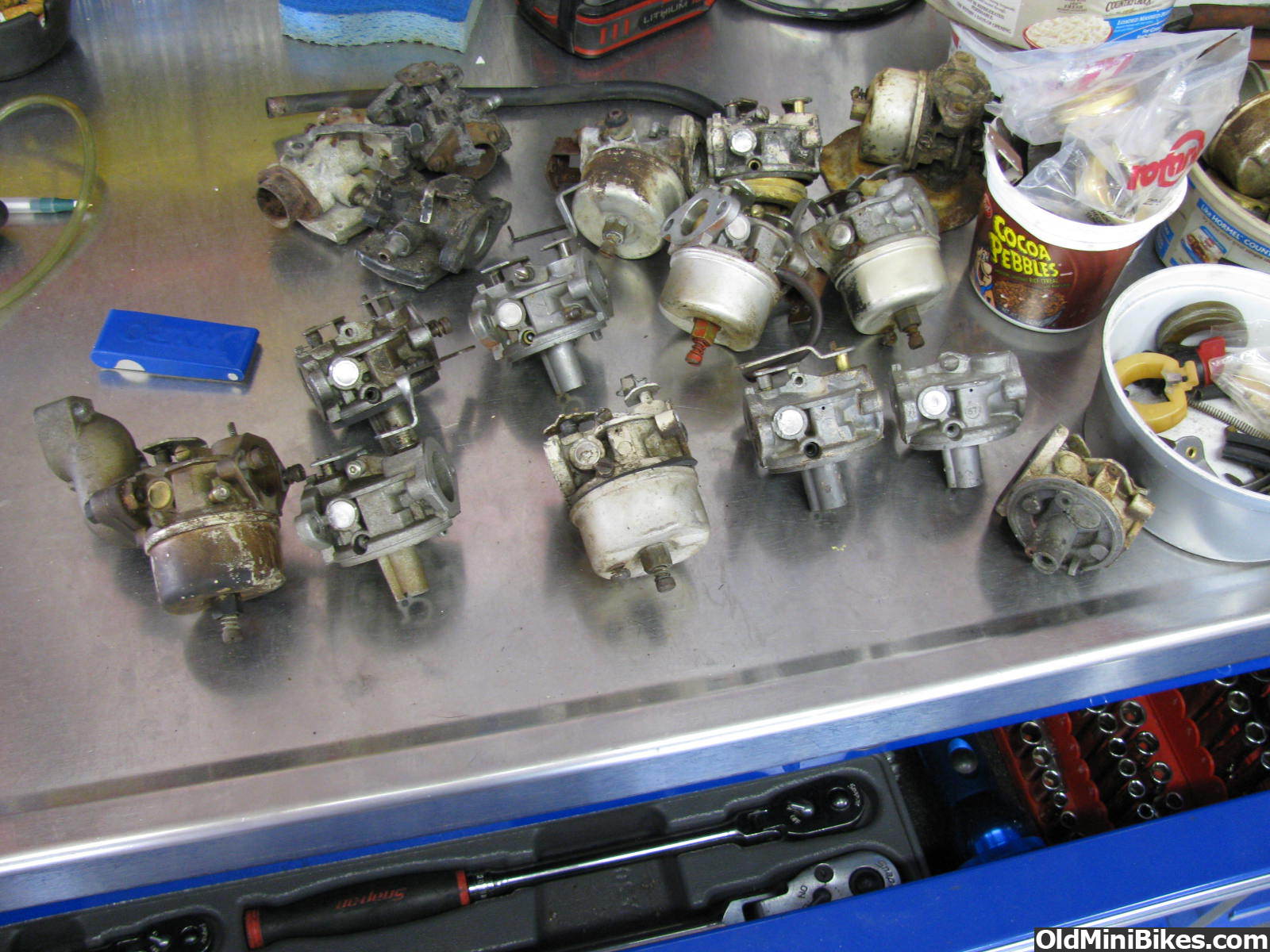

Cleaning up my excess parts and going through carbs right now, lotta junk :laugh:

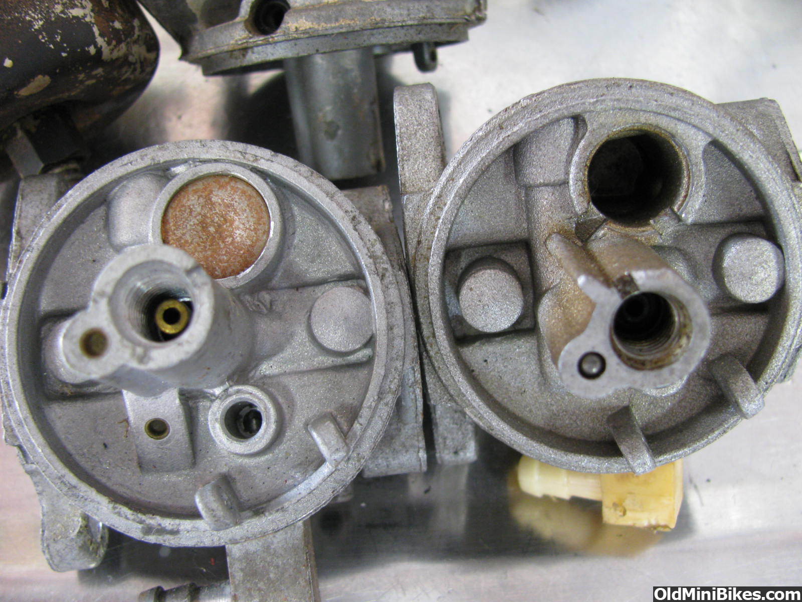

Anyway as I am going through these carbs I realized alot of the pretty clean ones I threw in the bin are primer bulb versions...probably because I didn't want to deal with flooding or anything like that and was avoiding them like the plague. Everytime I look at one of these carbs I can't see why it would flood if it was capped, there is still a vent hole to the atmosphere :shrug: But today with them side by side I noticed the difference! The vent hole at the top of the chamber is miniscule compared to a non primer bulb style carb, a piece of dust could clog that thing up!!!
left side primer bulb style, right standard non primer (upper vent is that little hole in the top center of the carb body.....
They both go to the same place in the carb body, when you have the bowl and float off there is a welch plug that is visible, If you ever took one off when doing a good rebuild (the plugs come in the kits BTW) there actually is nothing there except a big void
right side shows carb with the plug taken out:

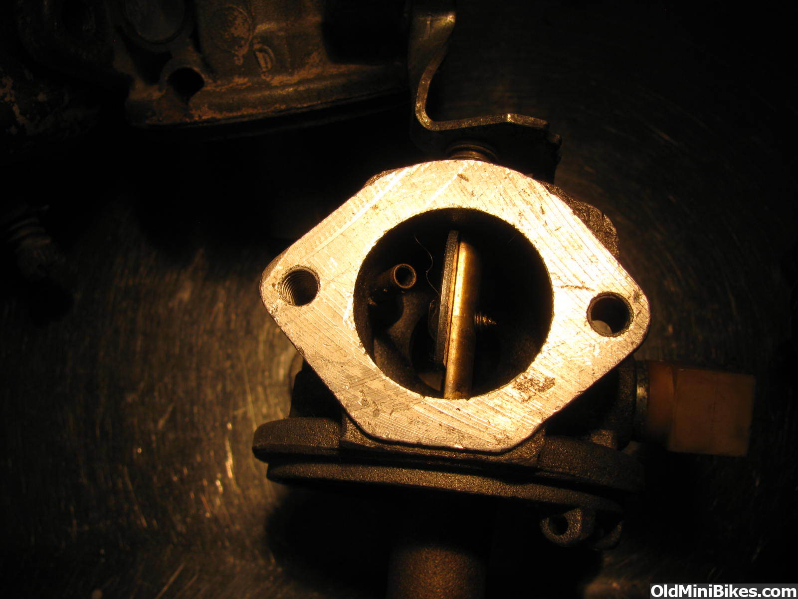

I even found another one in the pile that has no vent hole or inlet for primer at all....it has a direct line into carb body. I guess the theory would be air drawn in while you are pulling the rope would almost act like an Automatic prime :shrug: that's truly just a guess BTW
