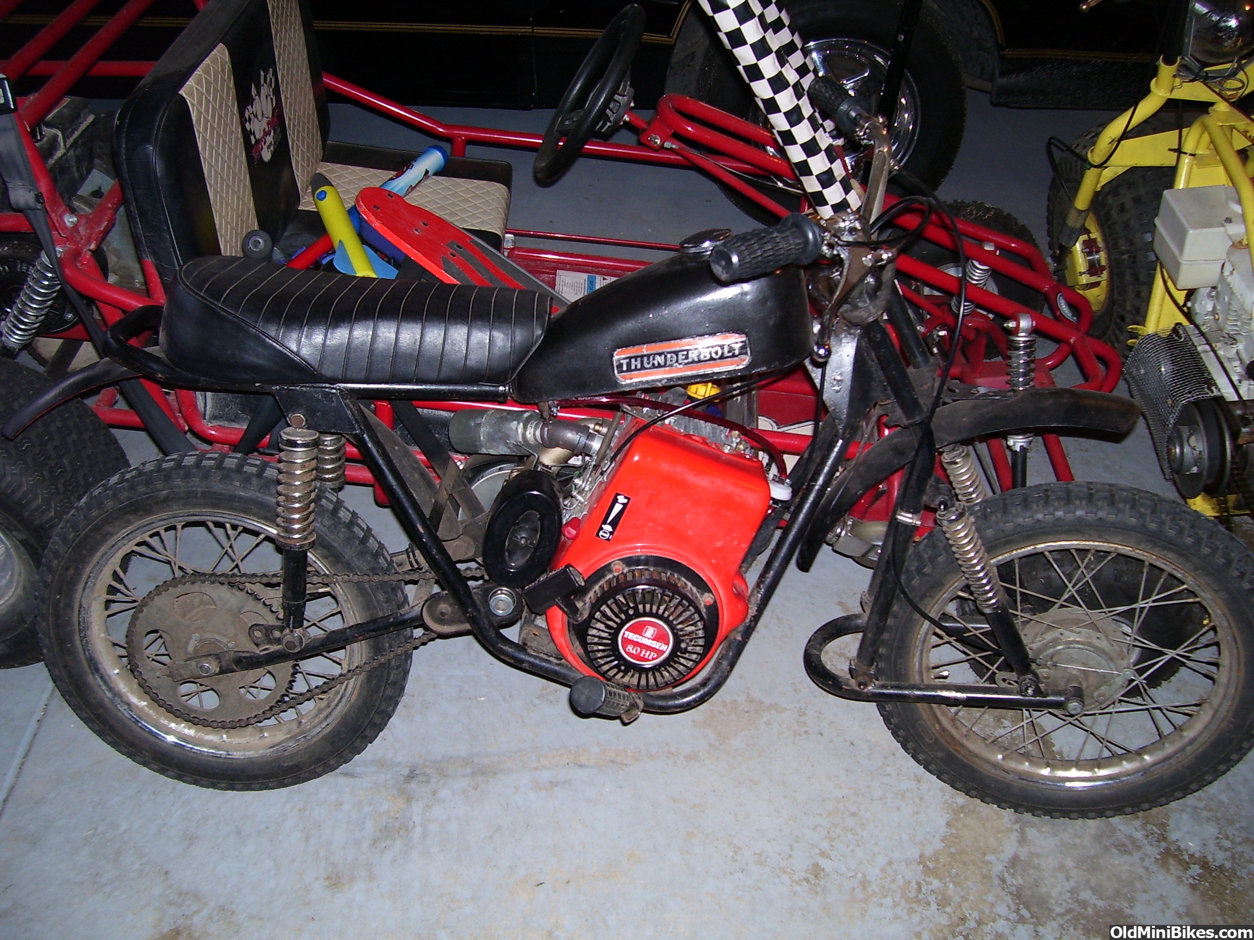

just wanted to post some pictures of my thunder bolt with a modified clone engine on it and yes for you vintage flathead guys. this will go back to stock in the future when i decide to do a full restore...:thumbsup: but for now going have little fun with it.....:scooter:
thanks again for some of the guys here that i pm them questions about modifying the clone engine...:thumbsup:
first thing i new that the factory carb setup was not going to work well with this bike. so i decided to go with a 22mm carb and also invert the carb intake and not knowing if it would work good or not at all. i have never seen anybody design this style intake. main reason i wanted to invert it was to keep the carb and air cleaner assy from hanging out and maybe getting damage from trail riding. for example at windber.:doah:
funny thing is i purchase this engine from harbor freight years ago(engine date code12-08) i believe i got it sometime in 2009?
first thing i had to find out what type of clone engine i had and the good thing was i found out it was a honda gx style engine and that just about any aftermarket part would work on it.:thumbsup:
right away i new i had to replace the the rod and the flywheel with the governor gone and then that lead into more aftermarket parts...:doah:...:laugh: valve train,head ported,cam,piston,billet rod/flywheel...etc.....
and yes the intake works great with my setup. bike pulls so hard at low end to mid-range. perfect for trail riding.
WINDBER TESTED
little up date on the project engine build. last saturday i had the some guys over and riding on my property and couple of them wanted to ride my bike. first thing they said after riding the bike was you need a helmet.......:laugh: you really do...
next day sunday, i decide to fire the bike up and right away i notes the engine was moving around little more then normal..:doah:
engine broke the front left and right factory welds for the engine mount plate and is trying to peel the plate back and snap off a low grade bolt i had for the rear exhaust hanger...:doah: i think it's putting out more then 6.5hp.........:laugh:
easy fix........:thumbsup:

So when will you start selling those intake manifolds? I am sure I am not the first to ask! Great story and good looking bike! Very nice!
delray
if you are seeing them on the east coast gumpit and for sale. i don't think you will see them that long on craigslist? they are kind of hard to find. i was told buy a older guy that use to sell them and his book show me they where built 1973 for a year or so only.
and yes i have enough parts to make three of them...:thumbsup:
what does the fox say.......:laugh:
delray
owend
I might even buy a clone to to use with your intake
hey, your more then welcome to copy my design. no patent on this ....:laugh:
with all the clone engines built,kind of surprise that no one has ever built a intake that comes across top of the motor like mine does...:shrug:
only thing i ever seen is a small invert over the outside of the recoil area.
glad it work good for my project. i like the fact too it fills in that empty space above the engine and below the tank area. otherwise it doesn't look so great with a clone on that type of frame setup. just a big empty space....
