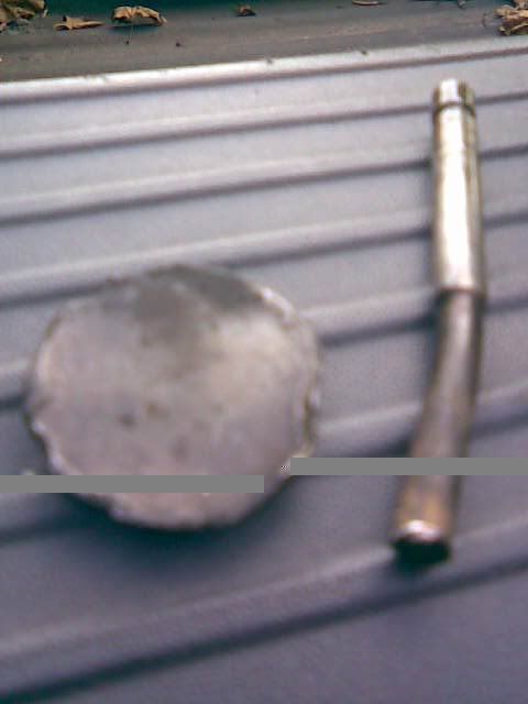

here's some aftermath video of my motor
Motor seemed to be down on power about 5mph, but it still was running good. Its a gx200 with big valve head and 2.992 bore that I bought off of mdb. I was running it on gas and it went 11'20s at 62mph with me a 250lbs rider. It went 68mph @ 10'30s with my 150lb jockey. This is 1/8th mile of course.
I made about ten passes and then boom. Got it home to find out it broke the exhaust valve off at the valve head. Here is video of the aftermath.

Looks like you got lucky . That could've got worse real fast. Did the motor just shut of or could you hear the piston f#&kin sh%t up.
#18
Valves just dont drop the head off, piston had to have hit it, one piece valves have way more tensile strength then the spring could ever create. Now if the springs get weak, you could run into valve float or what we call valve bounce, the 2 worst things you could do, bounce will fatigue the valve causing it to break in the weakest area, that being the undercut. Float just introduces the valve head to the piston in a bad way...:wink:
Not sure what he had in there, but we can get you set back up, head looks to have taken a beating, better check the intake seat as well....
That's what I thought . Worn out springs caused the valve to go to far. How long you guys think springs should stay in ?
Looks like your gona need a lot of machine work done. Good luck wildman .

I dont know how long springs should stay in, but MDB said they were fresh when I bought the motor from him. I only made less than 25 passes in 1/8th mile so I would hope they last longer than that:confused:
JD, The intake seat does'nt look to good either.
Heres a pic of valve stem, notice how half of the stem has been turned down.
