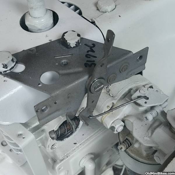

Just get Tecumseh part 31726. They show up a heck of a lot more than that other crazy setup. Much easier to install too. I find them all time. Here's one I put on my Sears Roper:
[/QUOTE]
If you keep your gov's on, there is another part number that is nearly the same I'd have to look up that allows for that. This one is from a constant speed bracket that I tweaked.
