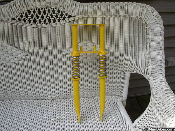

#17
This is what they looked like when I first painted them :thumbsup: They aren't as pretty now :doah: I'll get some new pic's when I get home tonight

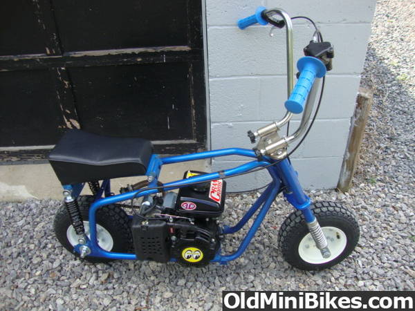

This is what they looked like on the bike

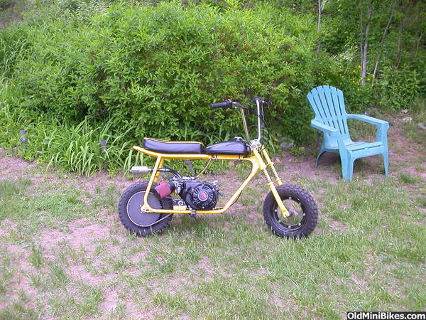

heres a basic example,give ya some ideas.
note the original headbolt hole is close to the edge,and the Size would have to be reamed out towards the Center or risk breaking.
good thing about these,they are light,and Adjustable.
