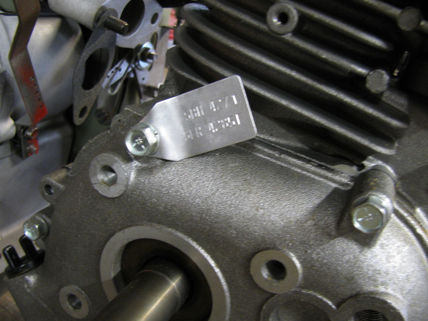

    If you are OK with being the reduced size exhaust valve and want to quit dicking around trying to find the right stuff there are NOS SBH's on ebay that you can use, you will have to transfer your early/small taper crankshaft (and sidecover unless you like the oil fill location-note late model sidecovers are usually thicker at the mounts so you want to use the shorter bolts from you early engine if you do transfer) Or if your upgrading to a Ball bearing shaft the correct sidecover for that will have to be used but your original engine number 67003 shows as being a bushing engine originally.
    I just ordered one of these, Its still enroute though. I am not postive of the year made yet but the revision on the sheet shown in the pic looks like maybe 2004. so its pretty late built.
    https://www.ebay.com/itm/Tecumseh-Sh...53.m1438.l2649
    I did talk to another member that picked one up as well and already has it, he verified that the shaft is keywayed (the parts number does indicated that but you never know and its not visible in the photo) so you could use a 1981-84 flywheel and parts and not have to even open it up if you have those handy and still wanted to do a points engine.
    Using the late model longblock assy SHOULD not be a problem, BUT I have not personally done anything hands on yet. I followed the revision numbers though on a 1994 SBH I have on the shelf right now which was the last of the big valve blocks. it is a mini bike/recreational spec replacement for pre 1981 engines, so its a block that has provisions for electronic ignition but came loaded with a pre 1981 ball bearing crankshaft. If you search the revisions of its number they show that they were stuffing the early taper crank into late model block after that for SBH's. So if you strolled into your Tecumseh retailer in say 1996 or later and said you needed a replacement longblock for your Rupp swifter shifter, monkey wards king cobra etc.. you would get the latest small valve block with the small taper shaft loaded into it, so Tecumseh was showing as doing it.
    this is the 1994 made SBH I have for reference:
    I have early blocks and parts, only bare blocks I have right at this minute though would most likely need to be bored. I have some that need to be taken down that bores look pretty nice visually and should spec out pretty decent but I cant get them torn down fast enough to help you right now unfortunately.
