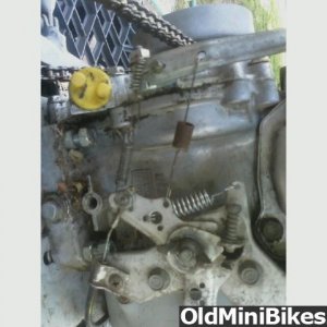

Yes I even siliconed every thing. But it still wouldn't return so i rigged that spring up to the lower part of the governor arm. This worked. Well worked when the motor wasn't running. With the motor running though I learned how the governor works. So now when I go to full throttle the arm...

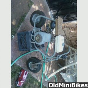

Bare with me guys I'm learning. First how do I make the photo i just posted larger. And here's why I really didn't get to ride today. I jimmy rigged the carb incorrectly and it didn't work. But my inquires are being looked at right now on a different forum. Is it forum or is it thread or post????
Ride postponed...... I'm going to go with a quote that every NASCAR driver has used at least once "The mechanics @#$%&* me." the only problem is. I'm the mechanic.
[/url[url='http://www.oldminibikes.com/forum/photopost/data/500/carb4.jpg'] Okay so here's what i rigged up. As you can see. Not knowing how the governor truly worked I added a return spring on the bottom of the governor arm. Only to learn how the governor really works. Lesson learned. Motra is...

Here's the problem. My type bb carb off of a late model Honda g200 running a flex cable with a new return spring is doing this. Having the twist throttle governor arm and carb throttle all in the idle position. I can twist the throttle and opening the carb throttle full. But when the twist...
