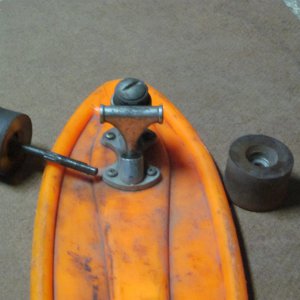

as stated,front chain tensioner broke off & was chewed up, threw the front chain. it was suggested to use a skate board wheel{great idea} my question is, can i mount it solid, or does it need to "float" with the chain to keep tension on it to keep the slack out???sorry no pictures. thanks in...

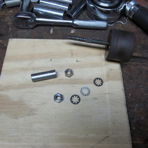

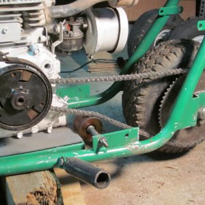

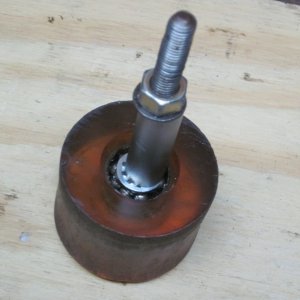

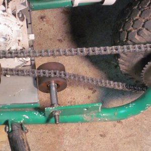

Thanks to those who posted their skateboard wheel chain tensioners Delray Aubornrox and others. It fixed a huge problem I was having with chain falling off.
New chain, sprocket and strengthening the mounting plate did not fix the issue. Finally I decided to go with a tensioner. I took some...
