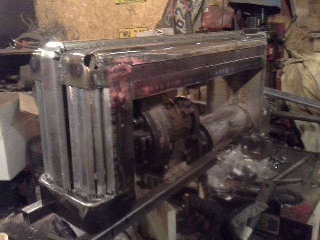

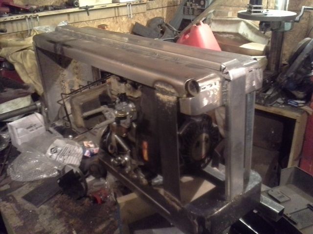

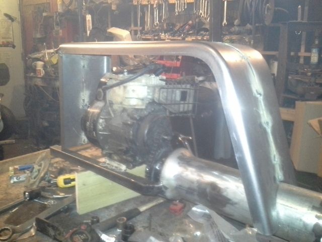

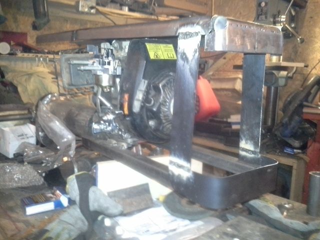

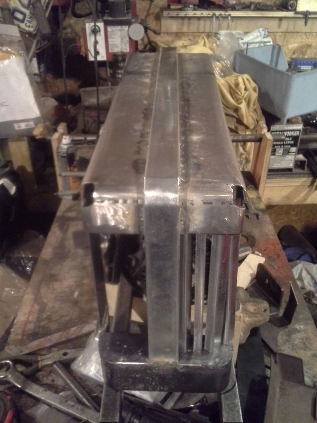

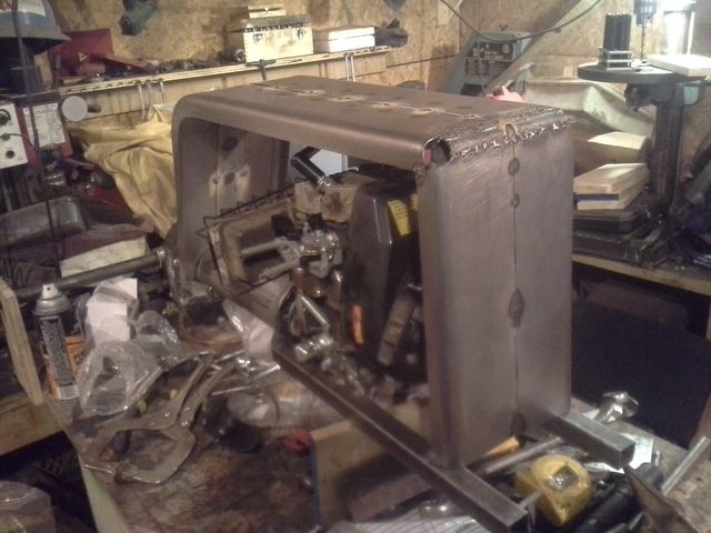

Then spent a couple of hours fabbing up the hood and grill
The fender ,angled at both ends

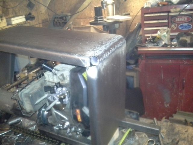

The angle was wrong for the front so I cut it of and used a piece of 1" pipe to join then
The fender was 9" wide and just too @$@% big so I sectioned it by 2" and welded it back together
It looks much better , but needs to be lowered by 2"-3" , it also will need to have the centre ridge added and grill cut out
