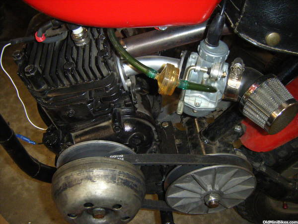

I think I was not clear on my explaination, with the larger jet it took off ran real good and did not falter, then it started a little at first and then with less and less throttle. Remember when you open throttle engine sucks more air, more air to compress, higher voltage requirement to fire plug, when I got back plug was black and a bit wet. If ignition was ok and it was just rich would expect blubbering and dry sooty plug. Now the manifold is a bit long and I am also wondering if I could have a reversion issue when fuel/air is blown back and sucked in again causing it to run rich. I am going to go out and try with new plug and 115 jet.
