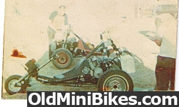

So, Made a midlife crisis decision to try and do something crazy. Decided to take the Alsport to Bonneville and race it for the land speed record of 350cc production bike. I currently have the original 290cc on the trike, and a 340 that I am going to start the rebuild process on this fall. You can see the list of trikes we have owned by going to FatSlobVintage on Facebook or Youtube, not new to the world of 3-wheeled American made trikes! Which brings me to why I am here on the Post! I need to hit 130MPH on my 340CC Kohler engine, and with that I am going to need a Dual Carb Intake for the Kohler engine. Anyone have any ideas or leads on where I could find one? Already have the Factory Alsport/Kohler Expansion chambers, and I recently installed the Wilwood brake setup on the trike, And if anyone wants to replace or put brakes on a full frame trike, get a hold of me as the Wilwoods look good, and work to perfection (not like the Kelsey ones!) I'll update this tread as time goes on if people are interested, I've got the trike to 73mph as is with the current 10 tooth sprocket on the jackshaft, so only need to pick up a mere 60MPH in my quest!!! All comments/suggestions are most welcomed!!

The Front end on the Street Legals are a Gem at high speed. I had the speedo at 73mph, but I bet I was going 65mph or so. On our Tri ROd with a 340 and 'highway' gearing, the speedo hit aprox 83mph. Again, not sure how accurate the original speedos are, but I was Flying in that thing when we buried the speedo!! I figure I need to make 60hp out of the 340 to hit over 100. I think its possible

I like the look and I also don't know about salt racing. I wonder if your trike has made the revised radius rod up grades there is a change on each end of the radius rods. Someone might have a copy of the factory notice. Take a picture of how your radius rods connect under the frame. and is your frame the double rail like they used on the Daytona Phase III ?

Steve, I uploaded some pics, I didn't know they had different radius arms!? I've got 4 other arms lying around, and we have like a dozen of the alsport radius arm clamps for the back, I just haven't installed them yet. And yes, it does have the dual tube frame, that's the main reason I decided to keep this one around for the long haul!
