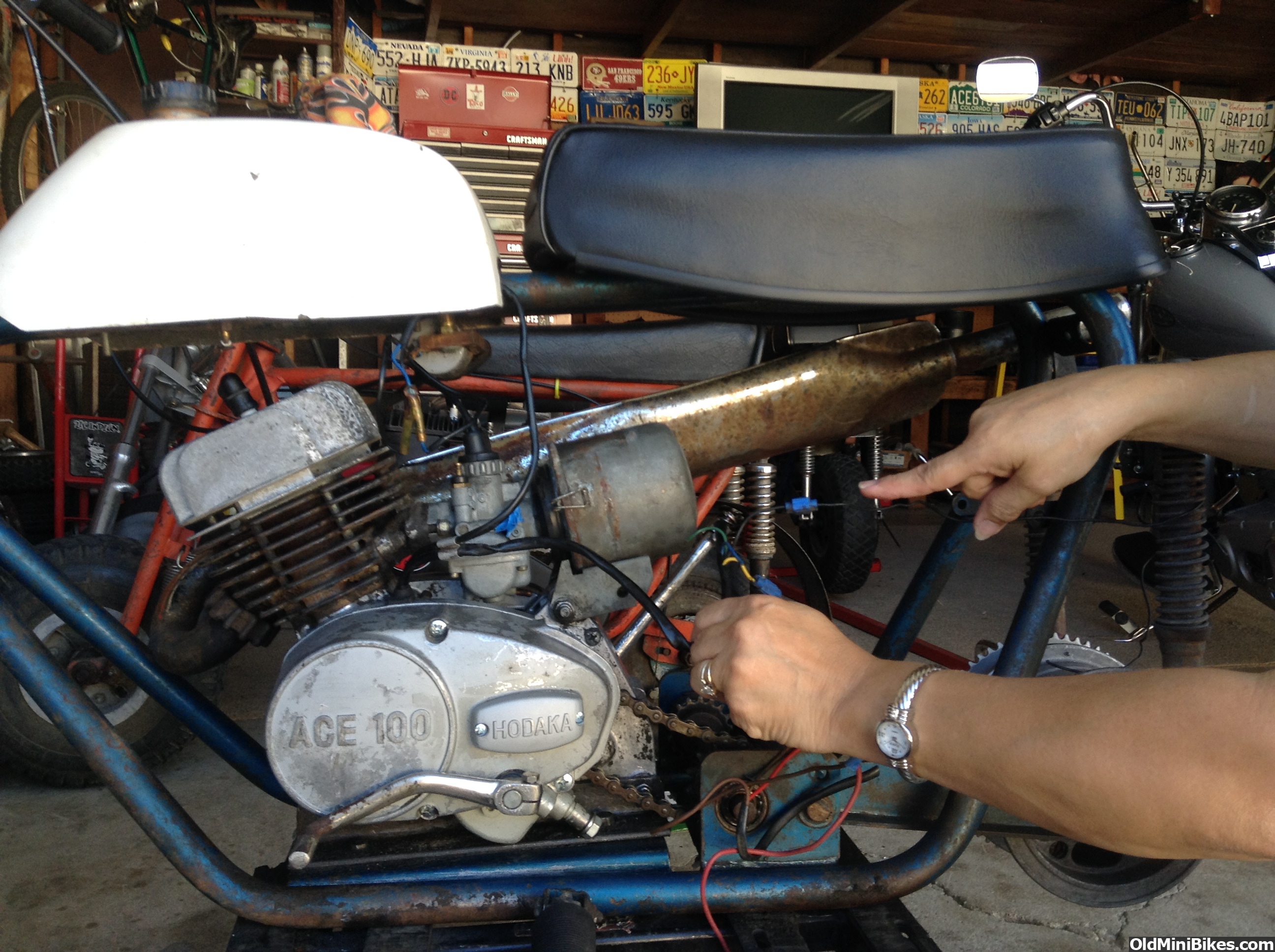

Ill help. There are 2 black wires coming from the engine case. One of the black wires is paired with the blue wire going to the coil. The other black is bundle with 3 other wires which are used for charging and lights. You use the black wire from this bundle and hook it up to the kill switch. You just have to ground it out to kill the engine. let me know if have anymore questions.
