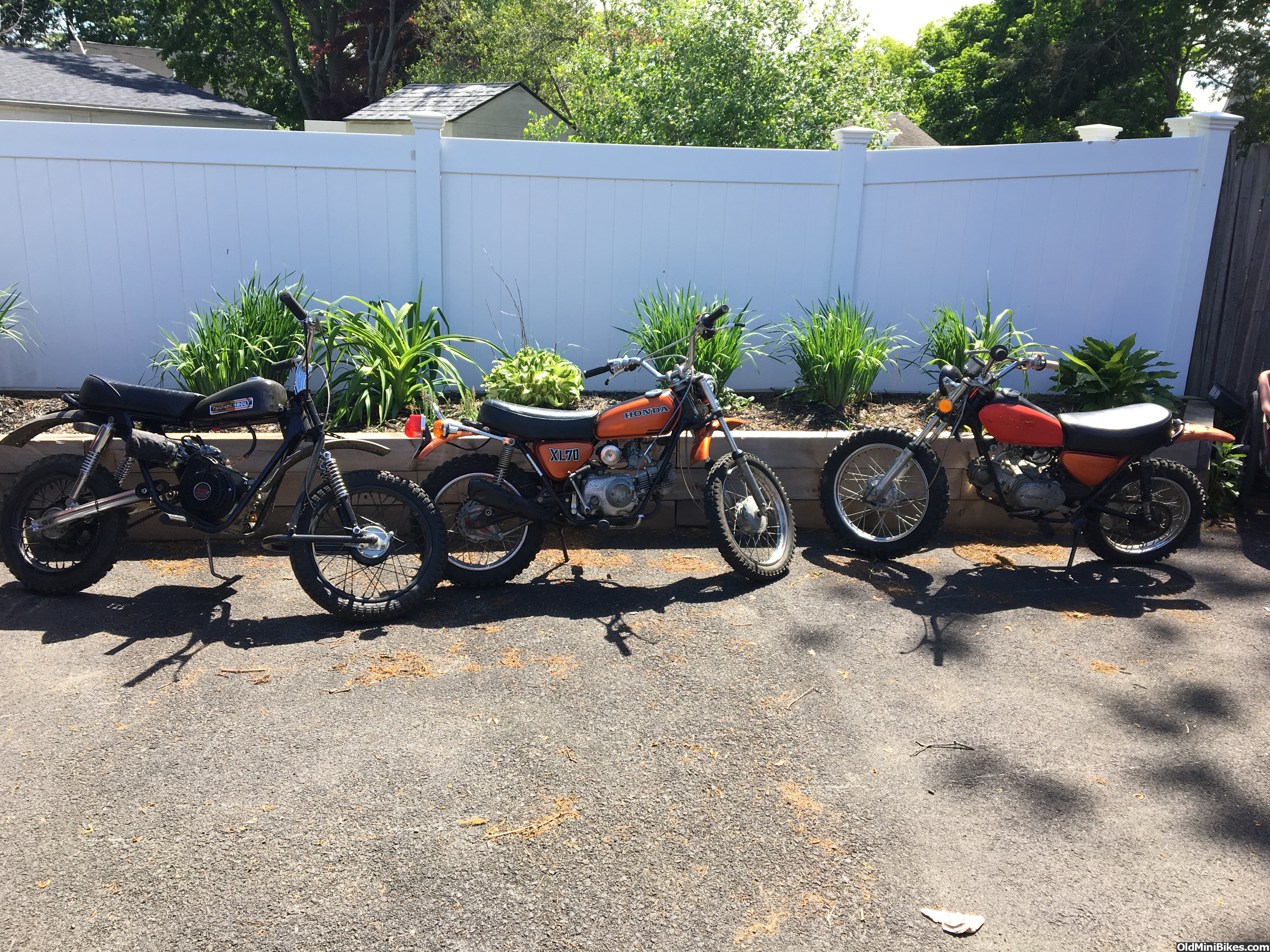

Fox Thunderbolt next to my Honda XL70
Fix Thunderbolt vs. Honda XL70
Pretty close but the Thunderbolt is just a little bigger. The Thunderbolt is fun and ready for Windber.But I love my new XL70. I was at a swapmeet yesterday and picked up another. I took the rear fender bracket off it and the two side reflectors and then I have to see which muffler is better. The nicer has a leak I can probably fix but maybe the other one is quieter. There is no spark and the spark plug hole is stripped so I will just have to try it on my runner and see. And while mine is off weld up any holes that are leaking. I need to finish putting on the directionals and little things. Not sure if I am going to keep the second one or not. Should be an easy fix. And would make a comfortable rider but I don't really need it so maybe it will go to the swapmeet in a couple of weeks or Windber running or not.
