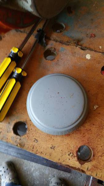

Can anyone tell me how to get this old rubber out of this gas cap? a It's old and dry and useless and gas leaks out of the tank. It doesn't look to me like the rubber goes around the center metal section but rather most of it seems under the metal. So I assume I have to turn this metal piece counter clockwise to get it off the rubber then lifts right out? Also where would I find a piece of rubber like this as a replacement? Thanks.

I believe that the three pieces are riveted together. You would have to drill out the rivet in the center and pull the pieces apart...which is probably not feasible! Got a pic of the other side?

JT, if you get me dimensions, I could probably cut you a gasket to go over the top of that one. I have some Buna-N material that I can laser cut. It doesn't look like that cap will come apart without a fight!

Is the rubber just stuck to the rust? Don't they spin freely and stretch over the tabs when not brittle?
X's two. :thumbsup: I cant imagine riveting, or sandwiching a rubber seat in a permanent fashion. Not at all, not if the cap is big, not if the cap is tall.
Lube it up, spin it 'round, yank it out, the answer's found.

I agree with the others...probably dried up and shrunk so much it pulled itself tight between the two cap pieces!! Cut that puppy out of there and stretch in a new one!!

Just pull it over the tabs, it is not under the riveted parts.
You can find another rubber one, OR cut one from cork
