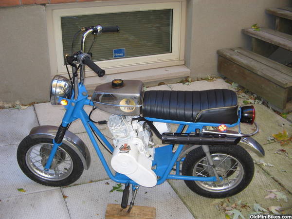

It's a Fox, what model?
Its the right clutch setup your just missing the outer half of a two speed clutch setup . you need another set of clutch shoes and the outer drum .here is a picture of one of my NOS clutches [not for sale sorry] .stevBMI has aftermarket two speed clutches on E Bay auction #190484844392 not the same but your only quick option
Thanks Fat Boy. I looked at the Ebay auction, I see the two drive sprokets, but the spacing would be way off. Can you tell me how this would work?:confused:
