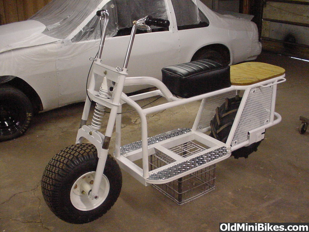

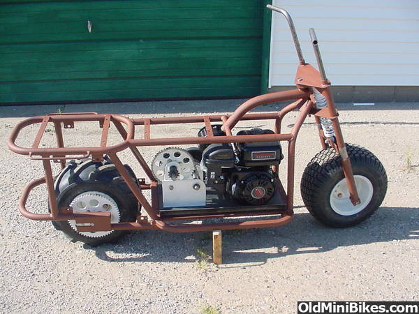

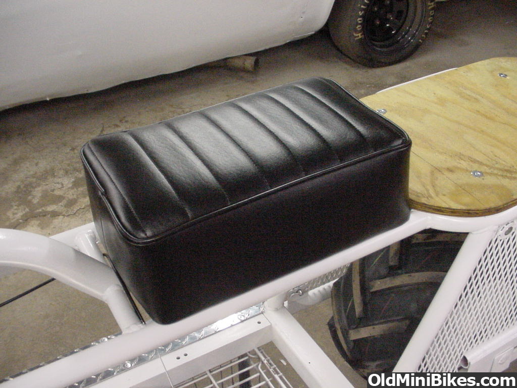

I'm back to working on bikes again. My primary focus is to finish my 2014 Build Off bike, Mr Goat 002. The first photo shows were I left it at the end of the build off period. As I walked around this bike for the last few months and looked it over and thought about the processes involved in building it, I have a few things that I will do different if there is an 003.

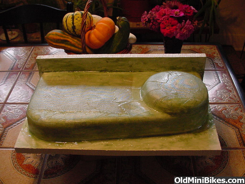

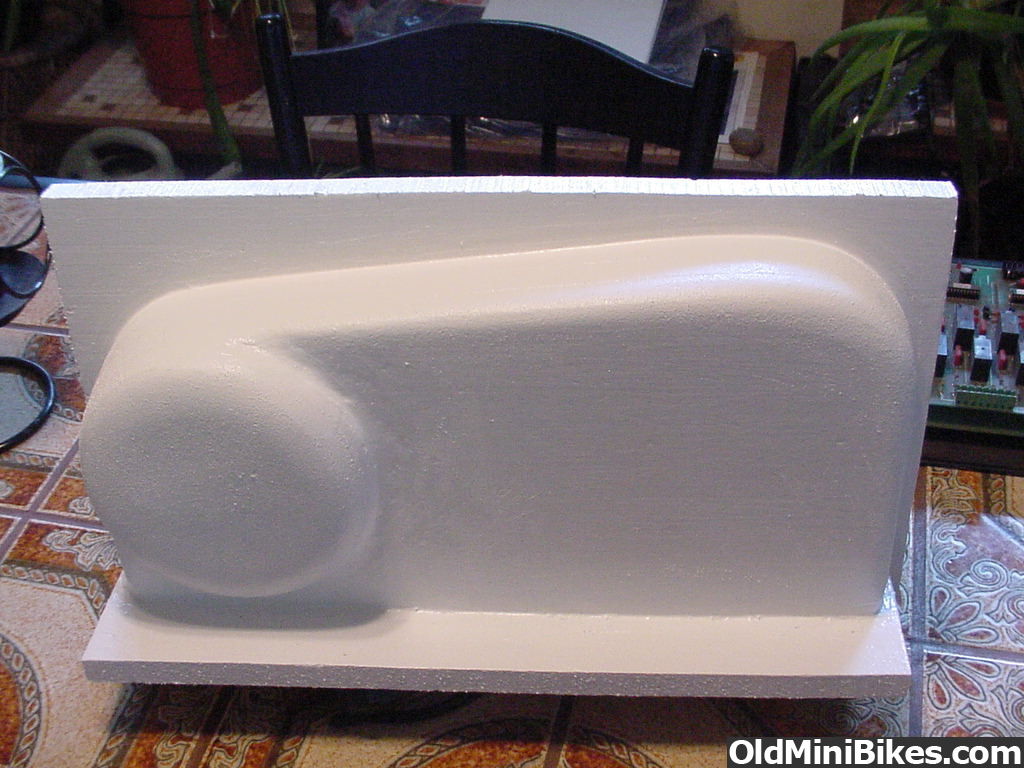

The second photo is the plug for a fiberglass torque converter cover that will be DZUS fastened to the drive pod. From the plug I will make a female fiberglass mold and then make useable parts from that.

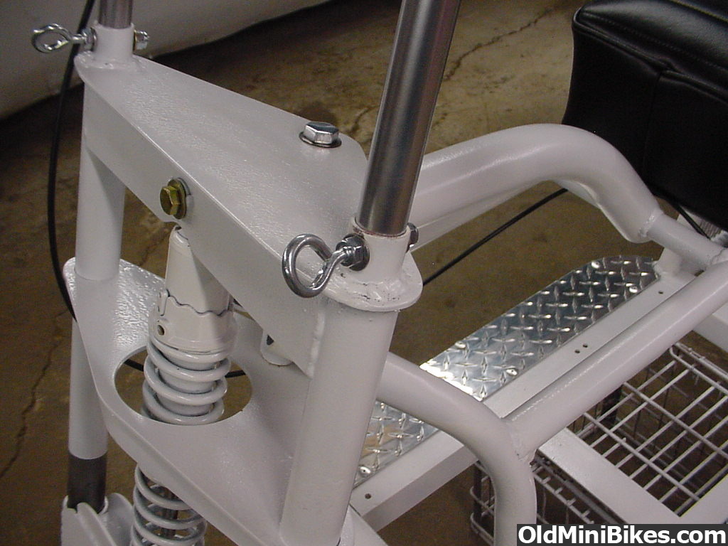

I painted the frame and forks Monday and really dread going to the shop to see how it turned out. There seems to be a lot of inconsistencies in Rustoleum Hammered paint that I have bought this year. Not just on this project but other things I have painted this year. One can will have no hammered effect and the next will leave large hideous fisheyes, all on the same project with the same Rustoleum primer.
