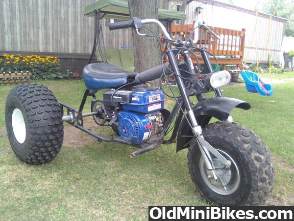

i just converted my baja heat into a trike. as you all know the heats come with a headlight. i replaced the original blown engine with 6.5hp clone engine. my question for all of you is how can i wire the headlight to the engine?? is it even possible?
not possible with your engine unless you buy a lighting coil/lighted flywheel set up = big bucks around $300 when you're all said and done with acquiring all the parts. Otherwise, go with a battery set up.
