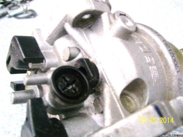

Where's the idle screw? Could you take a picture or draw a diagram or something? Is it the screw right near the throttle with the spring on top of it? Thanks!
May be a couple of rounds in...to see if it helps it idle. When the bike was parked and the engine disassembled, did you take the carb off ?
Yes I did take the carb off to get to the fuel line better, but I put everything back where it was, so I just have to try turning in the idle screw now!
