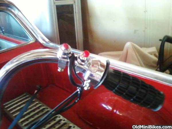

If a bike had a battery system, a one or two relay setup could be triggered by a single switch. A bypass toggle switch or switches would allow starting if the battery was dead.
Cool to see the trike running, it sounds great and looks geared for speed!
