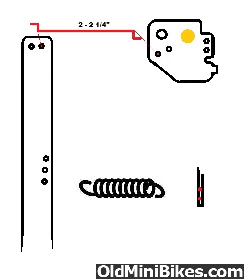

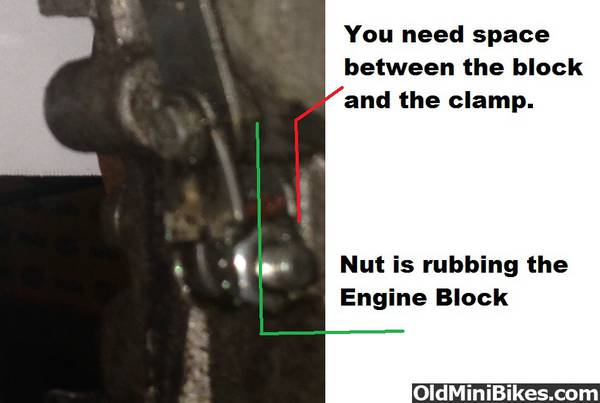

My tecumseh h35 is finally running! I am now having trouble connecting the throttle to the carb. The governer arm is loose and when i tightenvir it doesnt allow the carb to move. Any help would be appreciated! image.jpeg image.jpeg image.jpeg

That is just something your going to have to play with. How strong is your return spring?
If it is to strong, you have to over power it at the grip, by then its flipping to full throttle.
The combination has to be just right.
