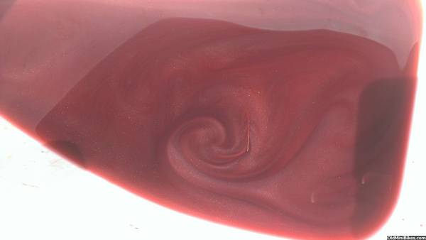

I was changing the transmission fluid in one of my Sachs engines the other day and noticed a metallic swirl. This is from a 47cc Saxonette on an Arctic Cat. I've been around these engines since the late 70's, with a 30 year break in between, but have never gotten around to asking others for their experience. I've seen this before.
I got a metallic swirl in the drained fluid. No chunks, thankfully. Obviously some wear. Normal or not normal for this type of transmission? I've done complete rebuilds on these engines (not this particular one) and the gears in the 2 speed auto transmission are very sharp.
This engine, however, is NOS and this is the first time I changed the fluid. It's had maybe 10-15 hours of use. Time will tell if this is a result of breaking in a new engine, normal wear, or major problem.
