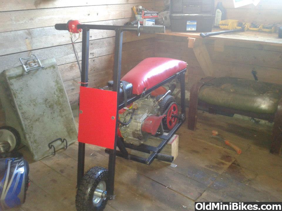

Just lately, I've picked up two mini bike frames. To try and build this thing.
Picking the best one I feel is suited, Changing out the front fork for a more narrow one, for the ski.
Re-building that fork into a suspension fork !:hack:
It is OR was an old school MX Bicycle fork , with the high-speed front adjustment.:laugh:
Saving the other fork for wheel replacemrnt for summer riding.
No majour changes to the rear, so Track or wheel could be used in summer.
However, I will now be working
in reverse of my OG drawing plan.
I also picked up two more tracks and drives, just got lucky i guess.
I'm not useing any drives in this build, just the 4" rear tire (4.10x3.50x4) which is about 1" taller than the OG track drives.
Question ?
40/41 drive sprocket
How many tooth should I be getting with a 4.10x3.50x4 tire
I was looking at 54 tooth it's 9" O.D. OR 48 tooth it's 8" O.D. tire is 10"
Tire Plus Track would make it around 10-3/4"
