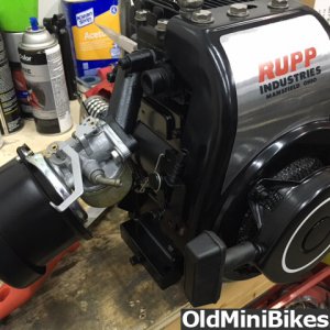

  12. HS40, Roadster 2
    HS40, Roadster 2
    Restored engine for 1971 Rupp Roadster 2.
  13. HS40, Roadster 2
    HS40, Roadster 2

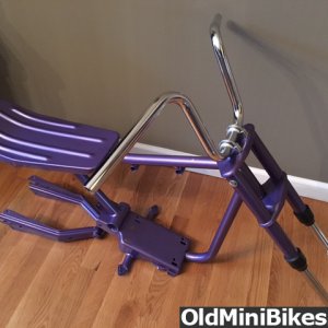

  14. Rupp Rodster 2 Restoration
    1971 Rupp Roadster going together after a near total restoration.

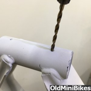

  16. Roadster 2 Swing Arm
    Rupp Roadster 2 restoration. The swing arm bushing is pinned/staked, making it difficult to remove the outer bushings. By drilling out the pin stake notch the bushings can be easily removed.

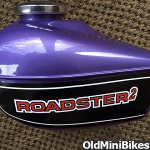

  19. Rupp Roadster 2 paint
    Rupp Roadster 2 restoration. The color looks much darker in the photo than it actually is. It's lighter and pretty close to original and that was the intent.

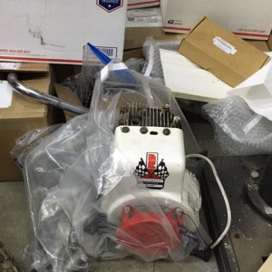

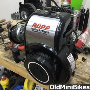

  20. HS40-had to start somewhere!
    Rupp Roadster 2 restoration. This HS40 is close to a Rupp Roadster 2, but lacks the longer PTO shaft. All indications are that it will still work on the Rupp even though it has a shorter shaft. It's hard to find a decent HS40 with a working lighting coil!
