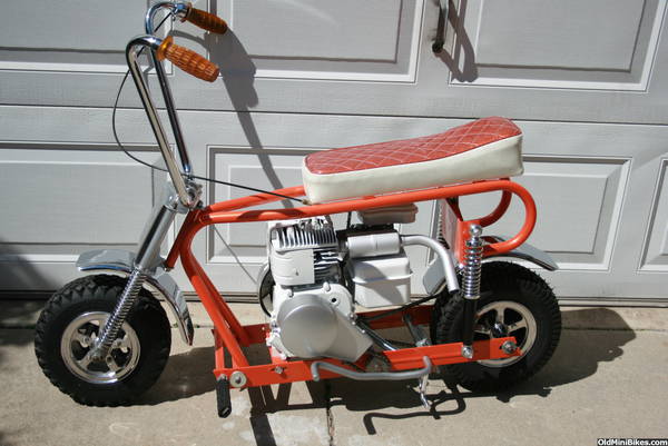

Nice ride there Skippy ! Why the ass end looks like a Campus ?? Curious as I no nothink about aggies :laugh:
CarPlayLB
It looks like a Campus 'cause of your limited eye sight and lack of real minibike knowledge! :laugh: I don't expect a lot from Louisiana anyways!
