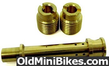

Where did you get your new carb from ? This is the high speed jet and e-tube from a clone / predator carb. You might want to pull the new carb off and take the fuel bowl off this jet is up in the same hole as the bowl bolt you took off . Good chance your new carb could of had some junk in it when put together at the factory, or possibly something could of come off the rubber hose when you installed the new carb.

I would poke something through the main jet and e-tube. It might be a new carb, but that doesn't mean it was cleaned right from factory. There might be a chip stuck in the jet.
